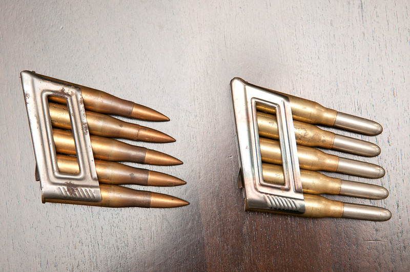

Correct. If you don't already know how to reload, but you happen to know someone who does, this is the best option. Reloading is not difficult, but you must be safe, thorough and methodical in your process. Unless I am mistaken, you will also require what is called an "enbloc clip". Similar in concept to the Gewher 88. This action requires a metal clip to hold the cartridges in place. You drop the whole 5 round "clip" into the open action from the top. http://en.wikipedia.org/wiki/Steyr-Mannlicher_M1895

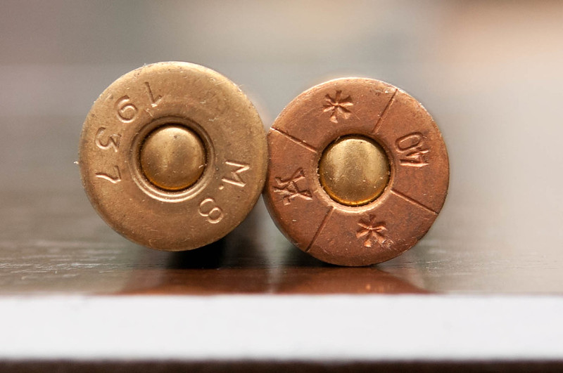

Is this 8x56R that I have here? Inherited a lot of such odds and ends from my dead friend's estate.
Spitzer bullet cartridge is the right headstamp.
Certainly looks like 8x50r on the right. Some countries did make ammo after WW1 for captured and surrendered M95s, Italy being one of them. Not sure who made your example though.

You can buy bulk Prvi from a few dealers, and get a reasonable price, but you will want some of the stripper-clips/en-bloc clips for sure. Watch out for the milsurp stuff, especially the Bulgarian stuff, very corrosive, you want to be sure to clean well after firing it.
