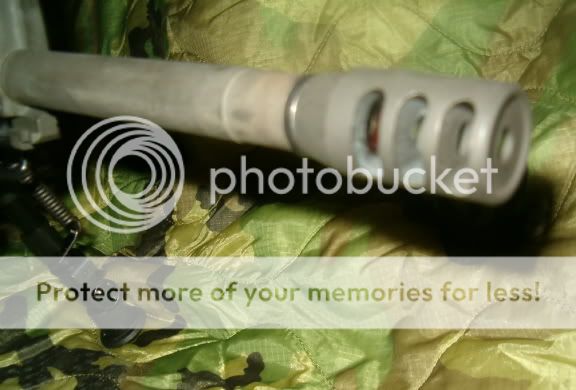

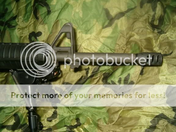

So I managed to remove my PITA factory FH. I had to use some heat ...I opted to try a propane torch first so as not to heat things up too much or too fast. Clamped it in a vise with wood blocks... a few grunts and a couple of "Hail Mary's" :mad: ;) :rolleyes: :D later and it was finally off. I installed my new brake that I got from Arms East (Thanks Walter!) and everything is now GTG.
