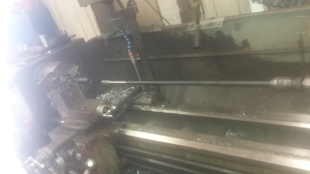

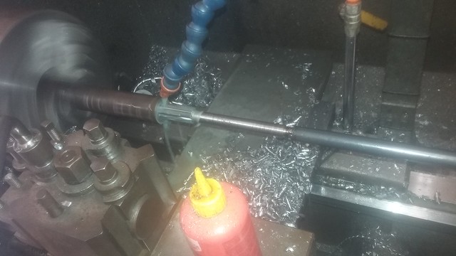

You have a 20+ inch, 6mm drill bit?
silver solder a regular 4" long 6mm bit to a 20" piece of 1/4" drill rod. turn the end of the bit to make a 4mm spigot and drill into the drill rod with a 4mm drill then get make a jig to hold them straight and solder solder away. you want it slightly loose to allow room for silver solder, or you can make a sweat fit/ tap fit then drill a small hole through the side and spot solder it in the hole
if the bore was bigger you could use setscrews to sold the drill bit in the extension rod
here are some pics but they are bigger then the 6mm drill talked a about but same idea, this is a 22mm reamer extended 36" with a piece of 3/4" hot roll 1018
