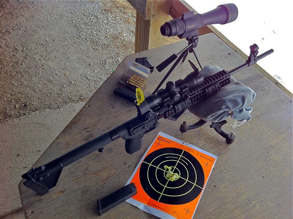

My recent trip to the range with my trusty Sub-2000 involved mounting an inexpensive 4x Leapers scope and a few new loads to test for accuracy.
I altered a somewhat +P load I tried before and played with the amount of powder by going down .1 grains at a time (7-7.3gr) and found a good accuracy node. The groupings were repeatable.
The final (best) load I ended up with is: 115gr FMJ/7.3gr HS-6/WSP/1.120" COL
This has the projectile flying at an average velocity of 1480FPS (at -5º, clear day).
Here's a pic with the setup and a target.
On this target if you exclude the two shots outside the main group, it measures just over 3/4" (full mag, 10-shots). I'm pretty happy with that shooting off just a bag.
