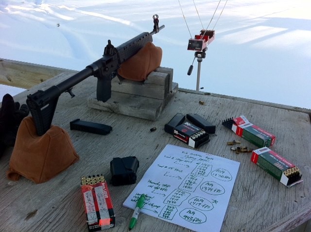

I kept saying I'd report on the ballistics in the other thread, so here's some data from a quick trip to the range today with 4 different kinds of ammo:
So I shot 6 shots of each type of ammo (1 to clean/prep the bore, and then recorded the next 5) then cleaned with a patch between loads. I didn't have a whole lot of different kinds of ammo on hand; but I should be picking up some more stuff tomorrow and I'll add to this post with everything else I try.
As per the small caliber I had the chrony about 5' away from the muzzle. Temperature was -9 and it was a clear day with no wind.
Here's what I found (average of 5 shots):
Sellier & Bellot 115gr FMJ: 1374fps
Sellier & Bellot 124gr FMJ: 1226fps
Hornady 124gr TAP XTP: 1419fps
Home brew 147gr JHP, 3.2gr titegroup: 943fps
Some interesting stuff looking at the numbers:
- S&B rate the 115gr FMJ's at 1279fps at the muzzle and the 124gr FMJ's at 1181fps (not a huge increase in velocity from the sub, quick powder perhaps?)
- Hornady rates the 124gr TAP XTP's at 1110 fps at the muzzle (from the sub there was a huge increase in velocity, I'm guessing they use a slower-burning powder)
- my home brew load I used data that produced 850fps out of a 4" barrel (so a decent increase in velocity through the sub, still subsonic which is what I was going for)

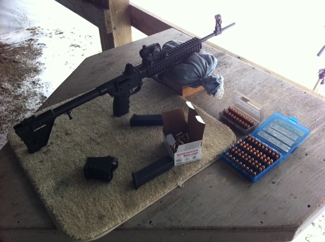

I headed to the range today to test out some more loads and got some interesting results. Same testing scheme as outlined in my original post (avg fps of 5 shots).
Temp: 2, no wind, snowing pretty hard.
I only tested one factory load; but what a shocker! This stuff is cheap!
Winchester USA value pack. 115gr FMJ: 1419fps
Next, my handloads:
115gr FMJ/4.8gr Titegroup/1.135" COL: 1366fps
- Super consistent; all shots were within 10fps of each other
124gr FMJ/4.4 Titegroup/1.105" COL: 1278fps
- Consistent as well, grouped well
115gr FMJ/7gr HS-6/1.120" COL: 1417fps
115gr FMJ/7.4gr HS-6/1.120" COL: 1508fps
- A little bit of a +P round. Shot great and had the best accuracy of them all.
147gr HP-XTP/5gr HS-6/1.100" COL: 1020fps
- My new favourite sub-sonic round. Cycled perfect and was quiet and accurate to 25 yards (could hit a 10x10" gong at 50 yards every shot too)
This target was shot at 50 yards while standing in practically a blizzard - my best grouping of the day (shot with my +p round). This is 10 shots. I'm pretty happy with the results (my little shotty that was with me today in the pic too):
I'll keep updating this reloading adventure with the little carbine as I go. I really am enjoying this thing the more I shoot it. I also never would have thought I'd have fun loading 9mm; it was always just a disposable round to me shooting handguns. With this thing it's pretty fun/challenging figuring out the loads and seeing the results. Thanks for reading.
