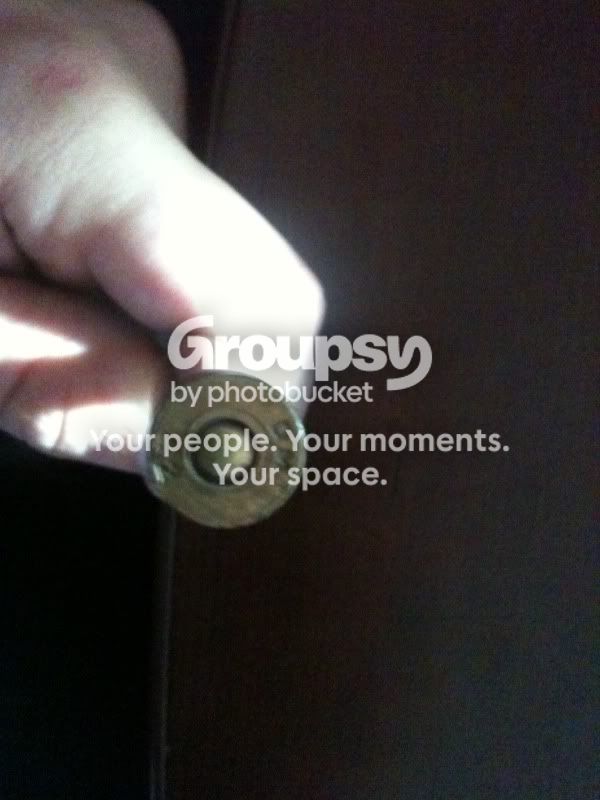

What are the markings on the case head, as that will give us much better information to guide you.
Made in the Des Moines Ordnance Plant in Des Moines, Iowa.
Will be corrosive, will likely be a 147 grain bullet.

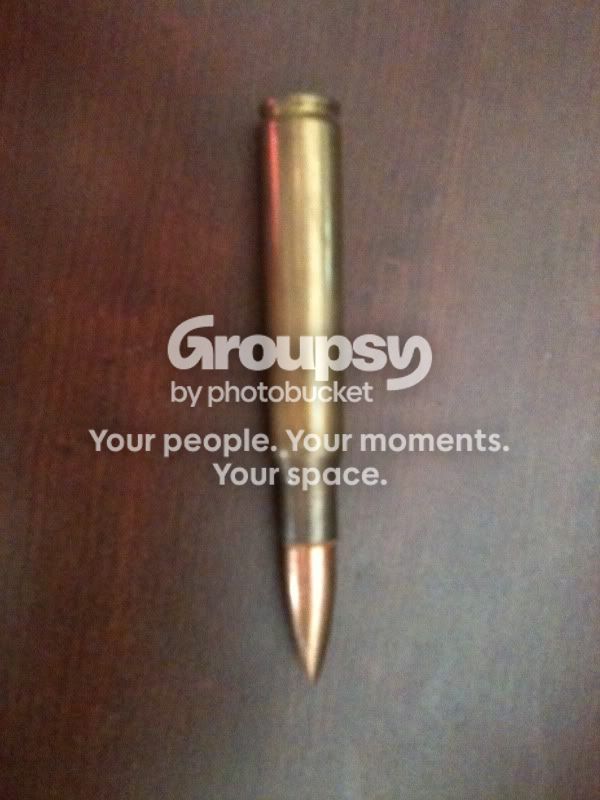

Are the bullets black or red tipped?
Eagleye.
Neither black or red.
It will be safe to fire in any .30-06 rifle in good condition. Hunting ammo is more likely to be loaded "hotter" than this surplus stuff. Clean the rifle after with some warm soapy water, dry and oil.
