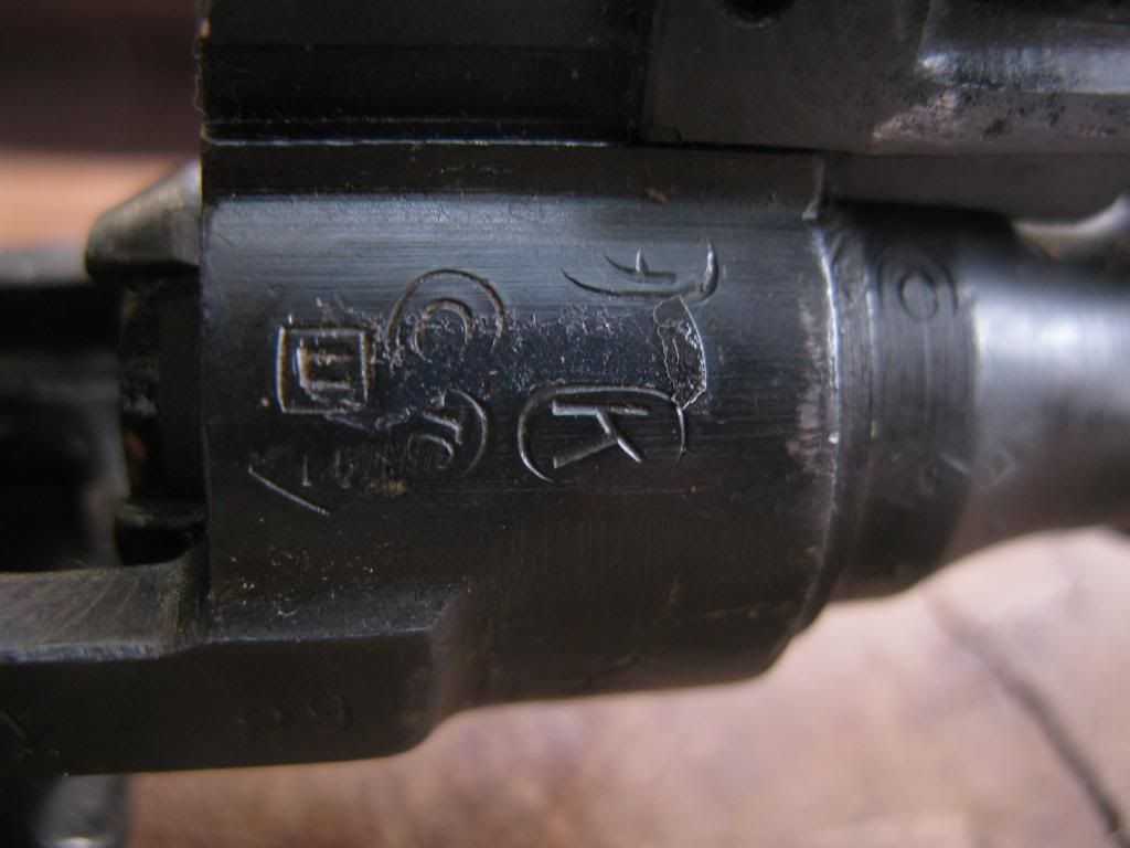

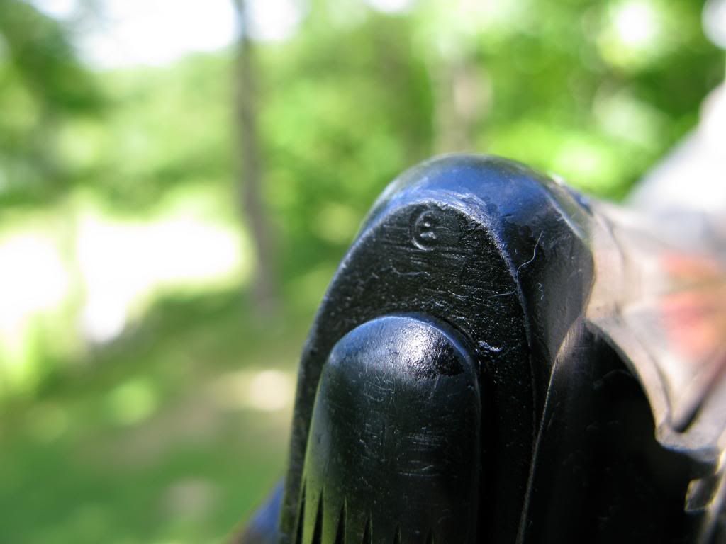

1941 snipers mostly were marked with C mark at the right side of the reciever. But some correct sniper rifles are missing this C mark.
All 1941 snipers had numeric prefixes less than xx 2000. Regular rifles can have sniper prefixes, but numeric prefix will be higher than 2000. There is one exception - in one known sniper prefix, НБ, few regular rifles are known with numeric prefix less than 2000. I don't know why this happened, but I have one assumption. I have another research about conformity of letter prefix and production month, and presumably НБ prefix rifles were produced at the beginning of July, just after war beginning, and it could cause some problems
