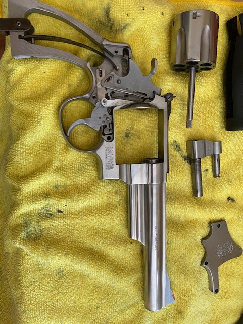

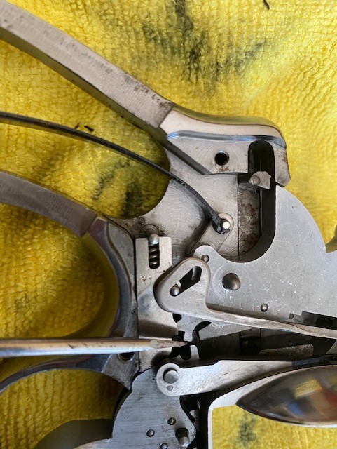

I just received a SW model 629 in used condition. I shot 1 round flawlessly, reloaded, shot 2 rounds then on the third it didn’t fire, I held gun pointed down range 60 seconds, nothing happened so unloaded. Now won’t go into SA? I cannot #### the hammer without slightly pulling on the trigger. See pics attached, where the screwdriver is pointed is where it is catching. How do I resolve this?

I should note I tried to tighten the spring tension screw under the grip and I tightened the revolver Thimble screw. The two tabs that are machined onto the trigger and hammer assemblies are hitting when I try to #### the hammer into SA

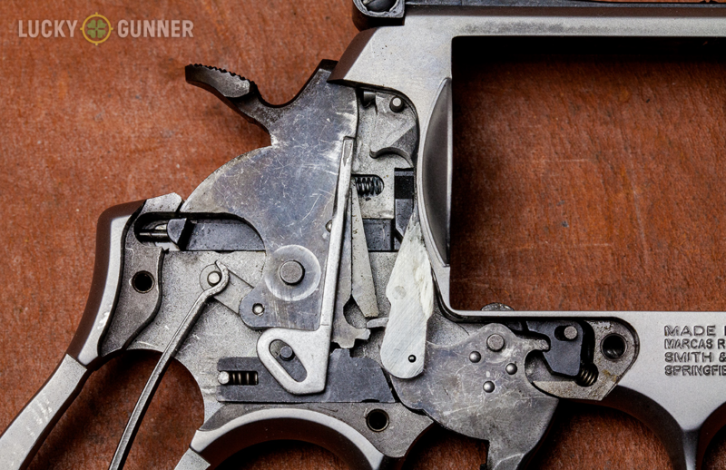

Also, please clarify "revolver" screw and "tabs that are machines onto the trigger and hammer". Do you have the side plate off already? Are you talking about the sear engagement? If so try to use this picture as a reference (since you haven't posted any pictures).

You can see the two tabs I’m referring to in your picture. Where the trigger assembly meets the hammer assembly if that makes sense? I apologize I am new and do not know the proper terminology but am trying to learn!

That part is functioning. I had the plate off and was watching where it was catching. It was the two tabs as mentioned between the hammer and trigger
