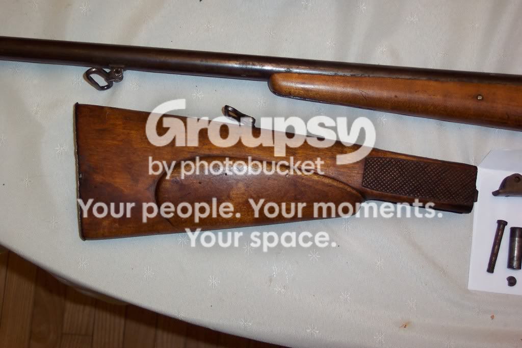

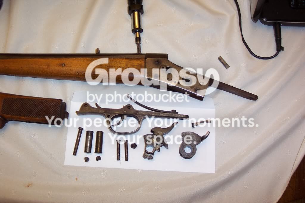

Well I finally took the plunge and stripped my Swede RB down and started to work on her. This gun accepts 50/70 brass with no mods other then shortening and shoots a cast LEE bullet extremely well so I decide to keep the bbl and do a complete refinish. Started into it before I realized I didn't have a pic of the before. Right now I'm polishing the receiver and will be chucking the bbl up tomorrow to start polishing it. The receiver will be case colored and the bbl hot blued if I can figure out how to make a tank. Built a forge out of an old bbq, a hair dryer and some piping. Works great and should have no problems giving me the heat I need for case coloring.

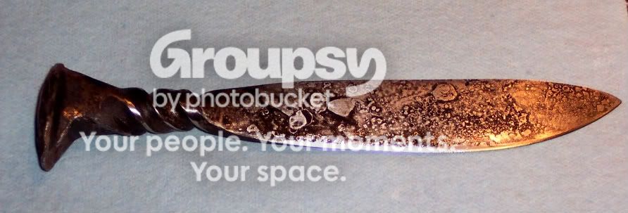

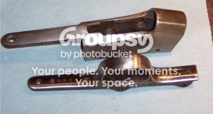

A days worth of polishing on and off and my first try at forging a knife from a railroad spike. Happy so far withe the RB. Took out most of the pits and dings without losing any of the markings.
Looks good to me, nice knife aswell!!

On the flats I used an angle die grinder with medium grit sanding/grinding pads for the coarse work then sanded with with emery cloth and a wooden block to keep the lines from rounding over. Had to do a bit of filing as well for some of the bigger dings. I used a well worn belt on a stationary 1.5 inch belt sander for taking metal off on the contoured areas of the receiver.

Isn't it great watching rust and dings disapear and the markings come out?
Like magic.
Great first knife ,a good option for decent carbon steel for a knife that will hold an edge better than railroad spikes is old honda coil springs. Leaf springs have good steel but it takes a ridiculous amount of work to forge them down to size while the coil springs from an old civic are almost ideal for forging and cheap as dirt. A good way to know when the blade is hot enough is when carbon steel becomes nonmagnetic.
