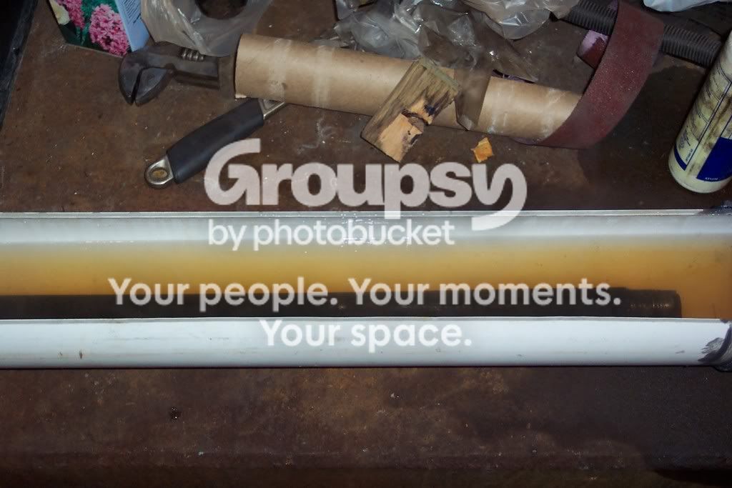

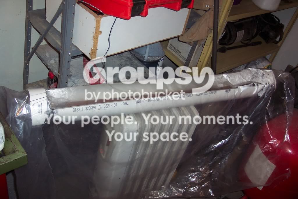

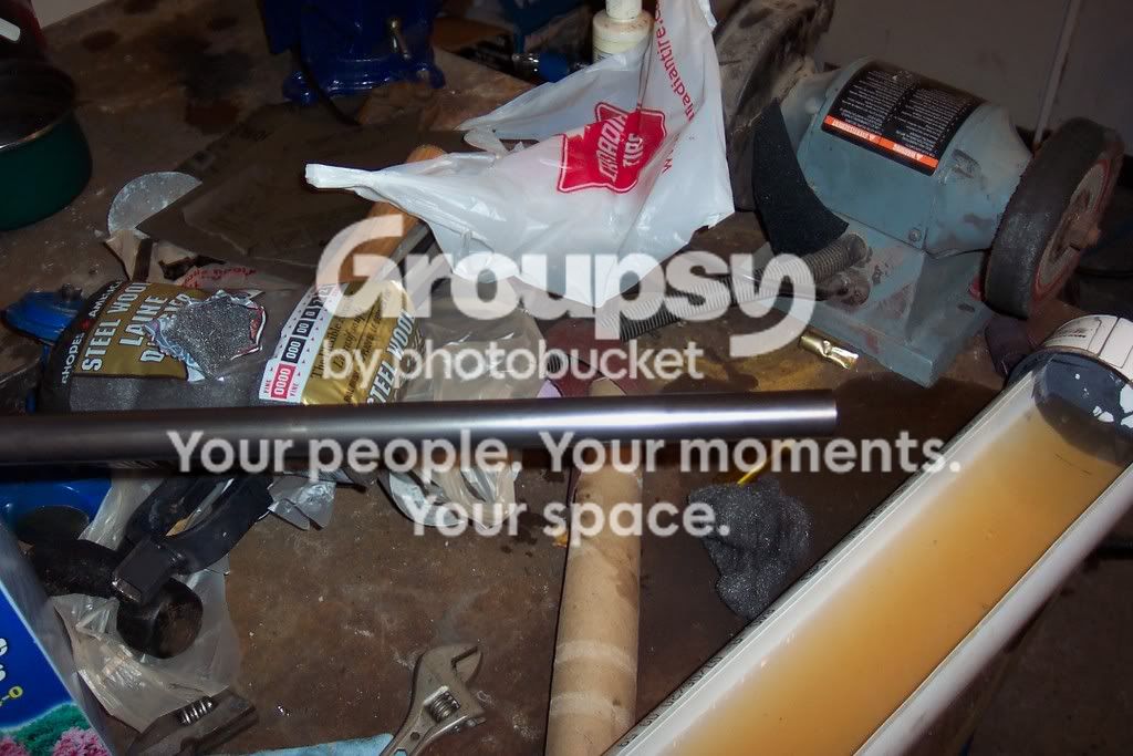

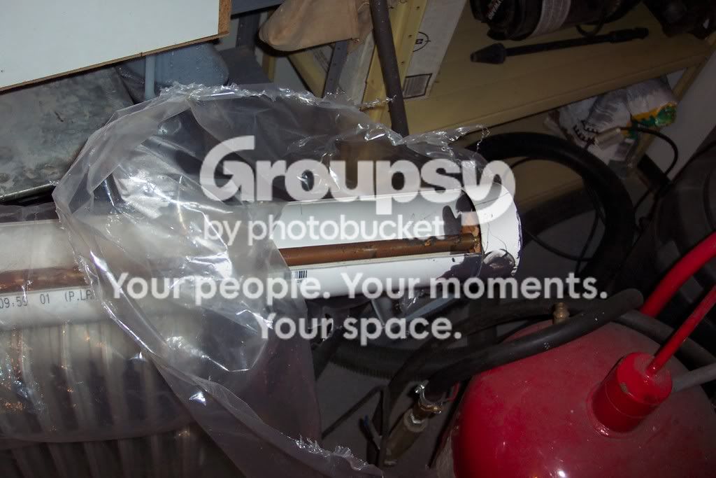

Built my sweat box today. The bbl should go in tonight. 4" pvc with caps. Just have to finish polish the bbl, should go quick on the lathe

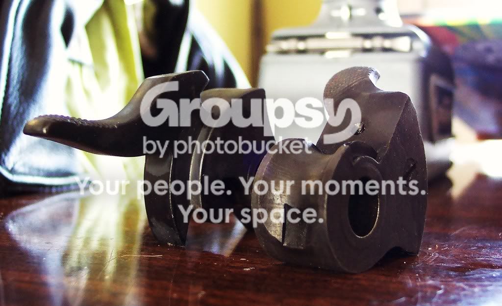

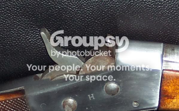

Rust blued the block and hammer. I didn't want to screw any dimensions up on the block or hammer so only lightly polished the rust and dirt off. I like the look. Doesn't look like a polished part from a high end shotgun but it looks "right". I think I want a couple more coats but am running low on the LMF rusting solution so will wait until I am done my bbl
Before
Looking good Juan! Nice close-up pics too. Your project is coming along fast. Thanks for keeping us in the loop.

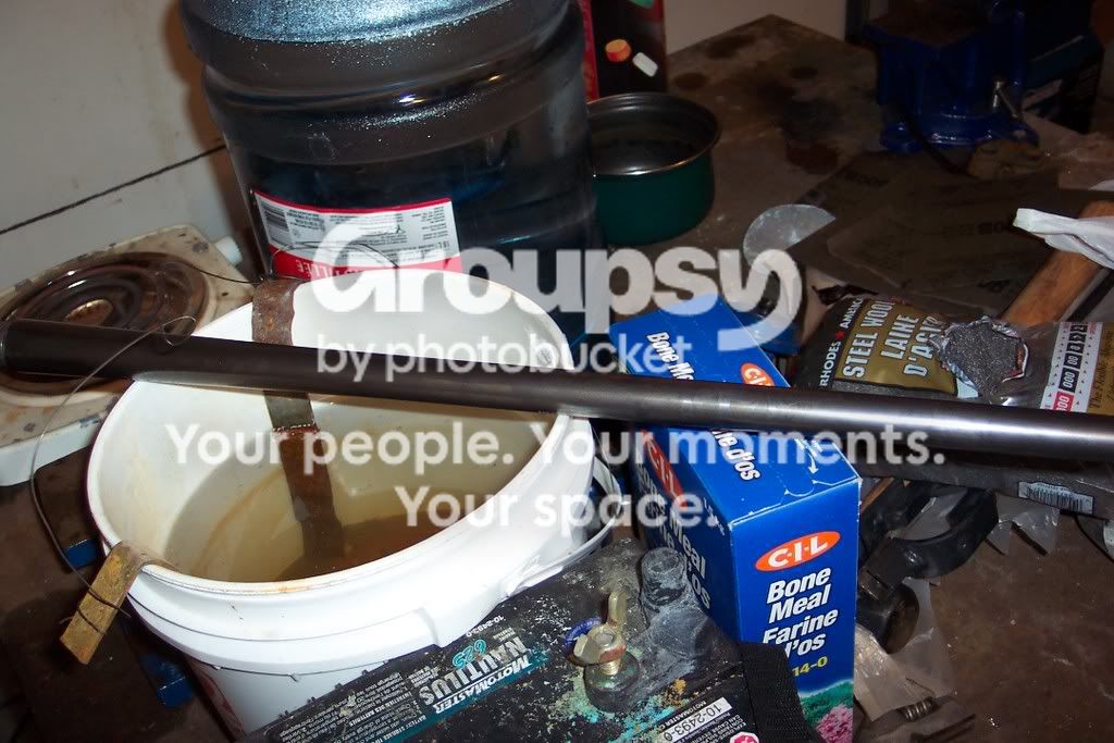

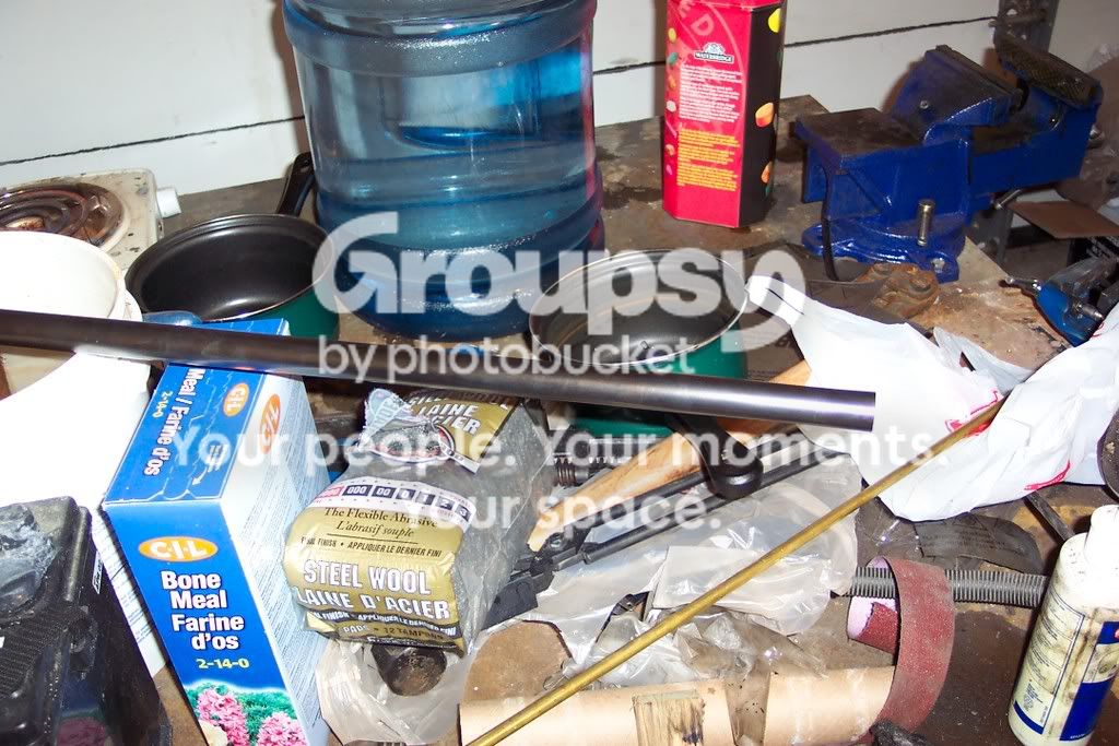

Here is my bbl after one run through the rust bluing procedure. Gave it a nice "black chrome" look but a little blotchy

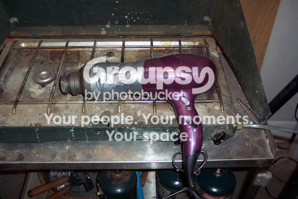

The blower for my forge

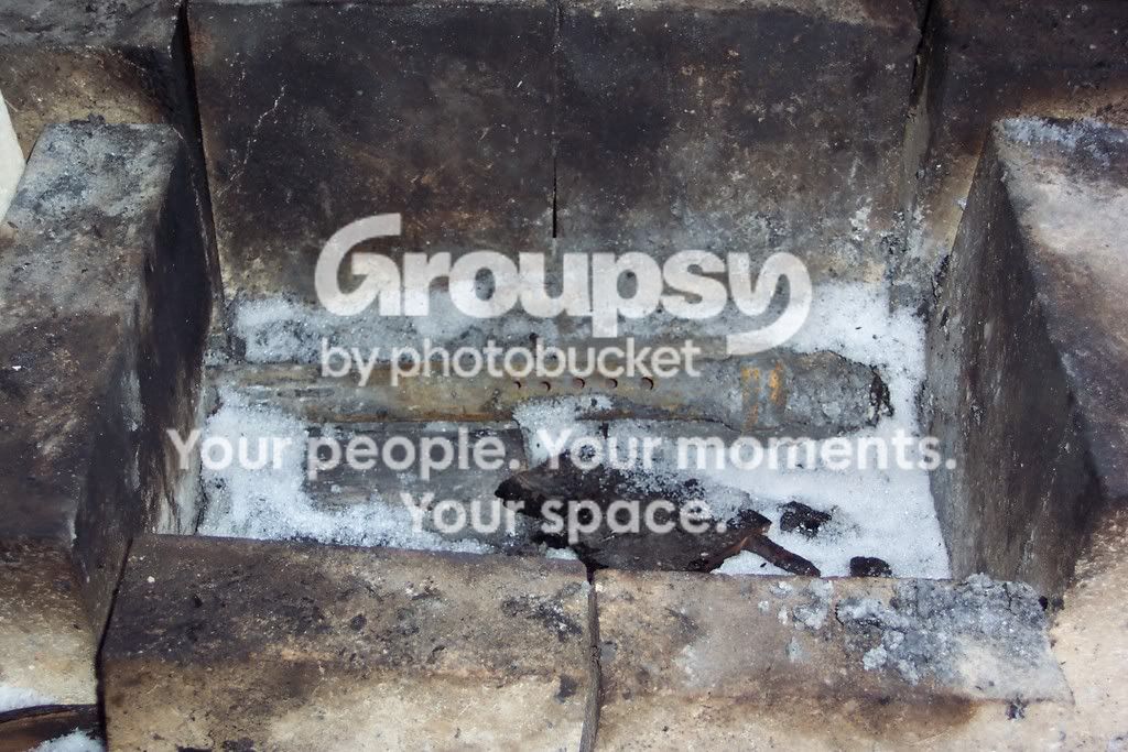

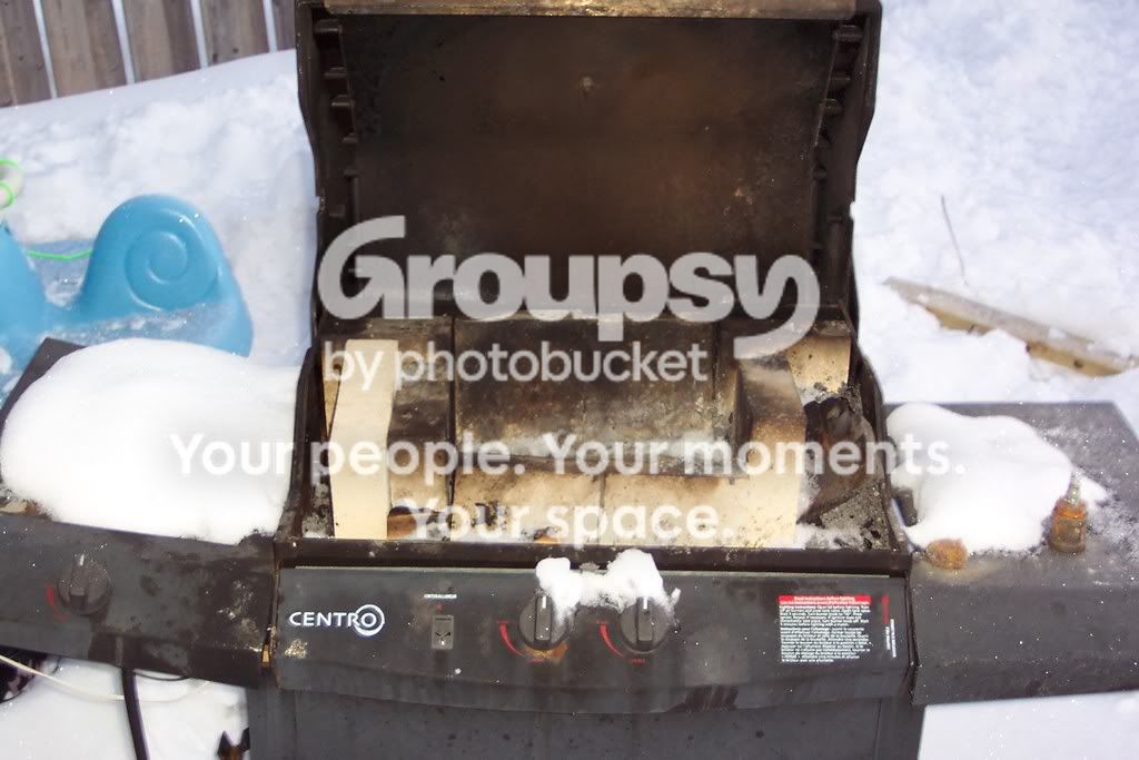

Here is the bbq forge, the pic isn't very good but it has a 3/4 inch pipe with with holes drilled in it coming through the side. I hook the blower on the thread end outside the bbq and cap the end on the inside. The hair dryer supplies lots of air, I'll probably get away with a low setting. I was thinking of adding a dimmer switch for speed control on the fan. My electronics friend says it will burn out the motor eventually but it is a 10$ hair dryer so...
Your sweatbox is brilliant but watch your nosy neibours don't get a quick look at all your improvised set ups or 5the meth lab squad will be at your place like they were in S-Toon for some kid genius's chemistry set.
