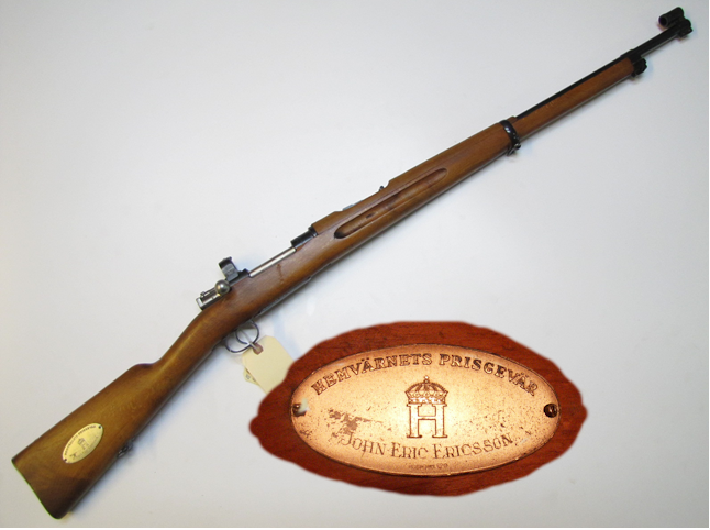

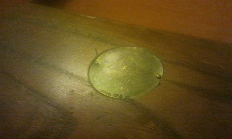

In making a guess based on your information, the "AP Boras 1917" on the stock is either a Name of a Civilian Shooter who owned the rifle, or this was a "Prize Rifle" given out as a shooting prize. The latter is quite probably as there is a Date on it.
Is it a disk or a plaque? Military disks contain bore information and are not dated.
Its written D8 on the plaque in really small character, thanks for the info!!!![]()
D8 is the year code for 1930. Your Silver Plaque was made in that year.

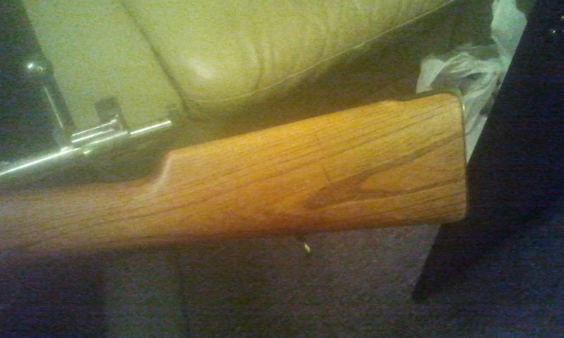

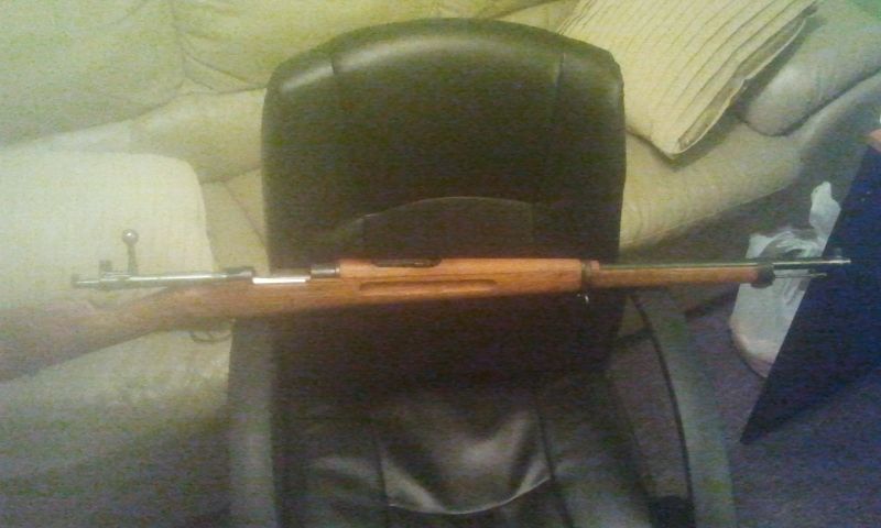

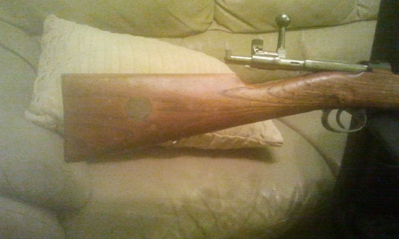

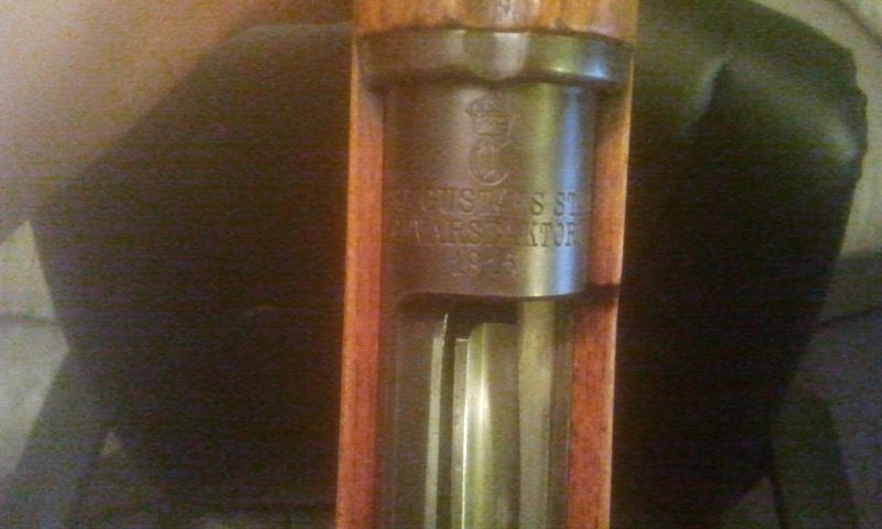

By the way, post some good pictures of the rifle and particularly the stock. From your small picture, it almost looks like your rifle has an ELM stock on it. The 1916 year is correct for an ELM stocked rifle, and the serial numbers should be between 371495 and 401598. While not all the 1916 production had ELM stocks, other woods such as Walnut, Mahogany and Beech were also used, because the supply of Walnut was drying up due to Wartime production and shipping difficulties. After 1918, most Swedish rifles had Beech stocks. The ELM stocked rifles are very desireable as not a whole lot of them were made compared to overall production of the M/96 rifles.
As far as I recollect, there are about SIX known mahogany stocks. If you have one, there is a line stretching from here back over to Sweden with people with HUGE piles of money who want to take it off you.

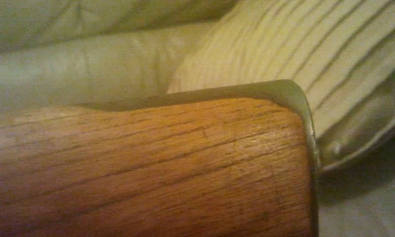

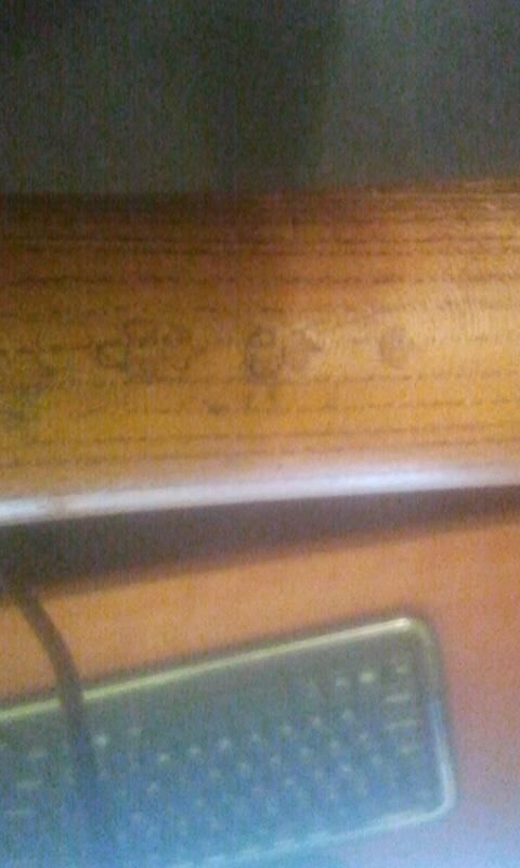

BTW, your pictures seem to have been taken in a sauna! Can you please take more of the area underneath the wrist [the thin part where you hold it] of the stock. I would liketo see the crown marks that might be there. Having said that, I think that the stock might have been refinished at some time.
BTW, your pictures seem to have been taken in a sauna! Can you please take more of the area underneath the wrist [the thin part where you hold it] of the stock. I would liketo see the crown marks that might be there. Having said that, I think that the stock might have been refinished at some time. The woodwork is supposed to be-

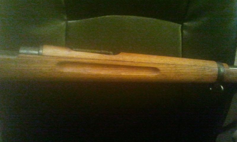

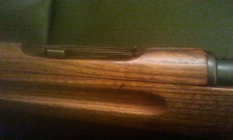

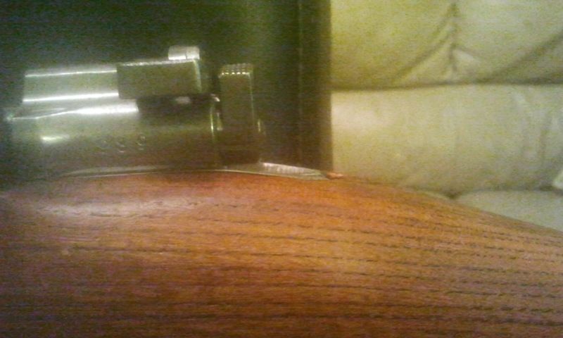

1. Higher than the metal work - everywhere - to allow for refinishing.
2. The finish is meant to be rough, even to having snadpaper marks, to make the gun easy to grip in cold weather.

It certainly looks like an Elm Stock on your rifle. I do agree with TACFOLEY in that it has been sanded, but really not that bad. The wood seems more or less level with the metal, and I have seen a lot of them that was well under the metal. Also, some rifles were sanded at the Repair station or Arsenal too.
Swedish rifles were inspected at regular intervals, and when this was done, or when the rifle went for a major repair or replacement, including the barrels, the arsenal or repair station, (Tygstation') that did the work stamped their code on the bottom at the wrist.
