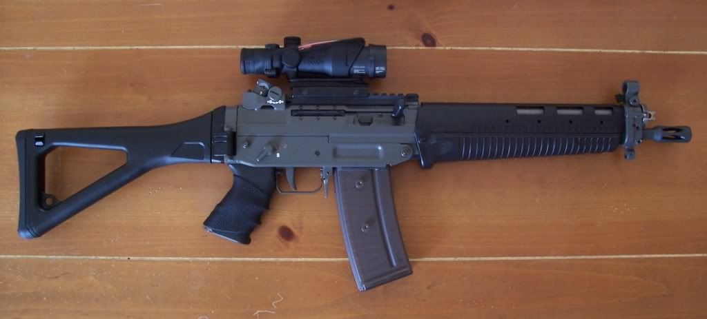

I really like the Swiss Arms rifles I own. Great triggers, very accurate and superbly reliable. more pics fellas!
the pair I have:
Maybe we can start getting the model names when you post pics. I'd like to learn more about these.
Or maybe, instead of pretending to be mentally handicapped, you scroll down the page and read one of the many threads dedicated to these rifles.
