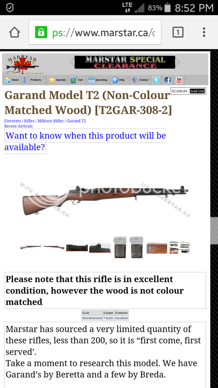

1. The rifle is assembled on a Danish surplus Beretta receiver, just like a lot of Garands that people here have built up on the inexpensive Surplus Danish receivers. It shows Danish military property marks and is not marked on the flat of the receiver heel with "7.62-2" as are the bona fide Italian arsenal built rifles. The Italian arsenals didn't use surplus Danish receivers to build Tipo 2 rifles for the Italian military.
2. The op rod is legit and is marked as for the Tipo 2 rifles. Interestingly, the side of the hump portion is not bevelled as are the 5 Tipo 2 op rods that I've owned.
3. The German assembler's markings are the same as the ones shown on the Marstar website.
I'm interested to see the barrel markings on these rifles. It will also be interesting to hear how the headspace measures on them-.308 Win or 7.62 NATO. They are marked .308 Win by the German assembler, but the Italians chambered them for the 7.62x51

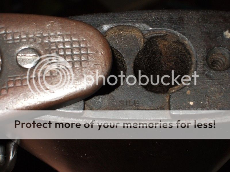

My understanding is that SILE is an Italian stockmaker who contracted for the Italian military in addition to making various types stocks for export . Some of the original Breda Garand stocks that I've had were made and marked by SILE. SILE also made replacement Garand stocks for the Italian military. The original Breda Garand stocks are stamped SILE in the interior around the buttplate trap area. The replacement stocks that I've had are stamped inside the barrel channel. The SILE stocks that I've had are well made and fitted up nicely.
So what is the verdict so far? Are these or are they not T2 rifles? Seems to me that it is looking like they are not.
Interesting that the one poster said his rifle is full of cosmoline suggesting it did indeed come from storage and is not a "commercial" rifle newly made up for export. But the markings don't match the known T2 markings.
I don't know....suspect to say the least. No barrel marking at all which is not correct, Danish receivers which are not correct, only "T2" marking is on the oprods, and they are not cut like other known examples.
Might be a good idea for owners to take some barrel/oprod/wood measurements just to see if they are the correct lengths lol.
Any mag blocks in any of these so far? The rusty oprod is not what I would expect on a Terni built and stored rifle either.
i bought one of the nos sile MT stocks converted by numrich back to original length and it was top notch, fitting perfectly. came in the original wrapper too.
lots of details not really adding up on these rifles... barrels should have markings of some kind.
I'd rather a tanker for that price.
For $2000 you could build one hell of a nice Garand....
I know it's been stated by some dealers already that the Koreans want $500-$600 per M1 rifle they are sitting on, and they don't think it's worth it as the Canadian market wouldn't buy $2000 Garands which is where it would need to retail to be worth it.
These sold out in a day....and the funny thing is, the second sentence in the Marstar ad says "Take a moment to research this model." Doesn't seem like people care...hell I may as well throw some 308 barrels on my Danes and sell them for $2k. Then sell the ####ty VAR barrels for a few hundred each lol.
This is the SILE stamp on the 1950's era Italian M1's

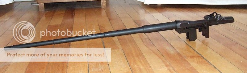

Also a .308 I built with a Douglass heavy barrel....gave up on it once I started loading 30'06...reloading is your BEST friend.
