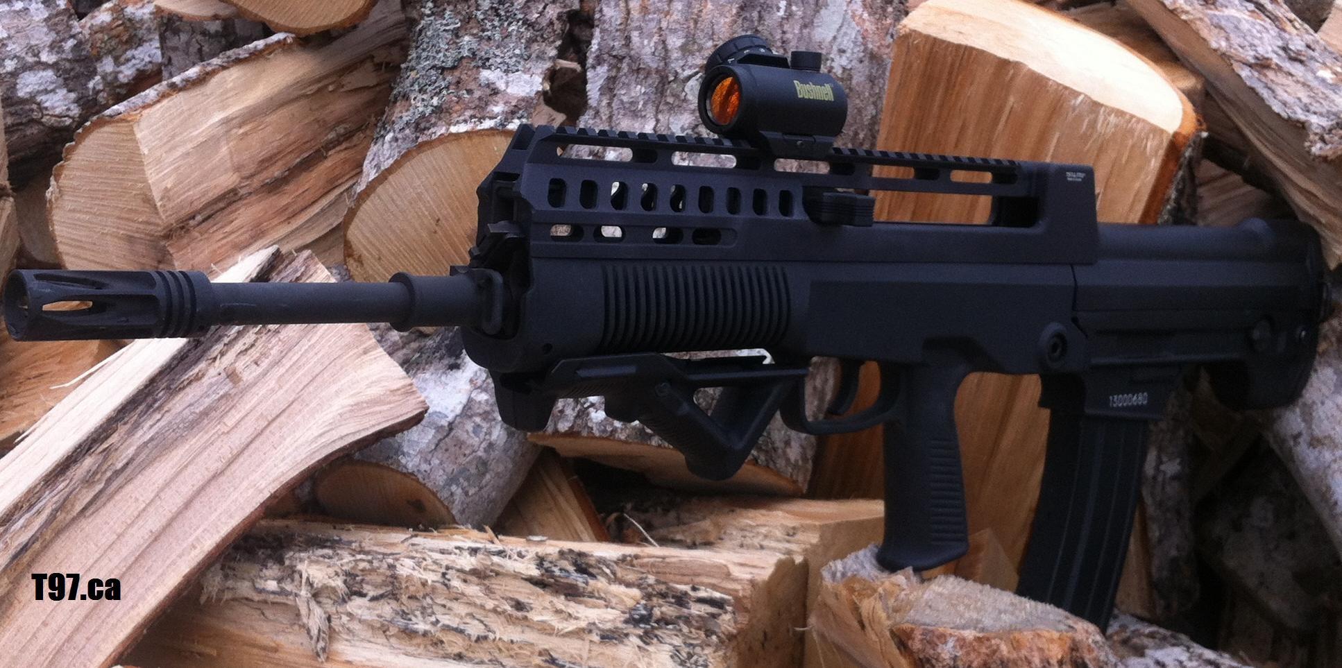

Upper
LINK: http://t97.ca/
Before I installed the FTU I could not seem to get any consistency in my shot pattern. The irons that comes on the T97 are not very good. The peeps are too small and the front sight is really hard to fine tune. not to mention that the front post covers about 8 inches of a target at 100yds. best group I achieved with the factory iron...6"...more or less. My advice would be to buy the FTU and a set of high quality AR-15 sights, like LMTs or TROYs. I know its a lot of money but... AND if your middle name is McGyver, you could drill the rear aperture slightly bigger and file your front post until its about 2mm to 1.5mm wide. Just my 2 cents.
I have the front post filed down already to a nice thin post.

So I decided to bore out the 100 meter/"1" rear sight aperture to the M16A2 precision aperture diameter of 0.070".
The original aperture on the T97 was almost half that size! Very tiny.
On top of that I made some small upside down triangle spray paint targets as well as a large one for the 100 meters trial.
Used older 1980's surplus US Green Tip M855 62gr again as it seemed to like it the best last time out.
It was a lot easier to get a clear sight picture. It also felt like it was straining my eyes less but that may have been the old placebo effect....
So I shot 10 round groups again as it's easier to read what you're doing right and wrong on the trigger.
Here is the best I could get out of many groups at 50 meters. The shell I picked up is a fired 2 3/4" shotgun shell for size reference:
I then pushed the target back to 100 meters. And again, this is the best I could do after about 9-10 groups of ten shots:
A little bit better than my last results.
So I've come to some conclusions on the T97.
The main issue with the stock iron sights is primarily that the aperture at the "1" is way too small, it's very hard on the eyes. With it opened up to A2 aperture size I shrunk my groups considerably although nothing mind blowing. But the other actual issue with the sights is that it's almost impossible to keep a consistent sight image with the front and rear sight. The round peep sight with a round front sight ring and a post in the center gives no easy reference as to whether or not your post is actually center of the ring for windage/elevation with proper eye relief. It makes for a hard strain on the eye, too much time to focus on the alignment of the sights which fatigues your eye by the time you think you're lined up and ready to focus on target hold, breathing, trigger pull etc etc.
That coupled with the long soft trigger pull makes for a bad recipe for trying to attain competent accuracy. Although for a bullpup trigger it's good.
