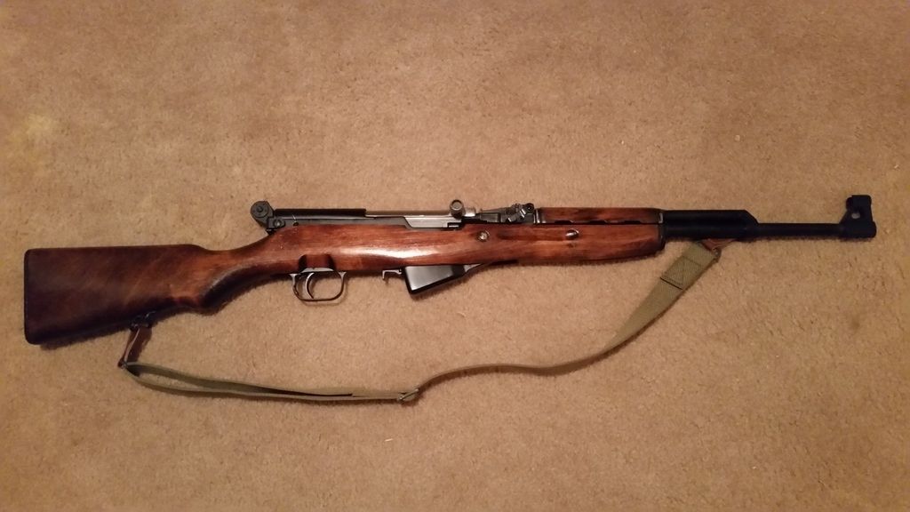

Here's my uber-tactical SKS
3 Coats of red mahogany stain & 7 coats of tung oil
Barrel chopped to 19" and crowned
New front sight assembly and front sight post fitted
Tech site rear aperature sight
It's a bit lighter now and better balanced too
Put 200 rounds through it after the mods and she ran like a top
Still want to do a trigger job though
Can I get some information on the front sight? Who makes it? Is it pinned on?
I bought the front sight from hical
It's their Trueshot SKS front Sight Conversion
I chopped my original barrel to 19 inches, sanded everything, then re-crowned and blued it myself before installing the front sight assembly
Installing the front sight assembly was easy, just slide it on, apply loctite to 3 screws and torque them up, wasn't difficult at all
The sight assembly did come with a threaded end which I thought would be handy, however it soon got the cop too
I also replaced the original SKS front sight post with a much narrower aftermarket post from hical as well
Since doing all the mods, I've now put over 600 rounds through the rifle and am quite happy with the results
Everyone stops to check it out at the range too... looking cool is so important
