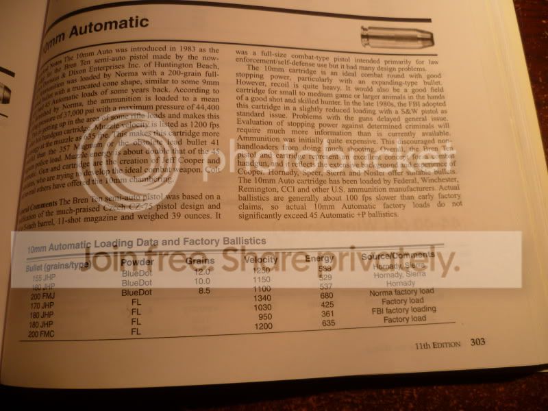

The Lee manual lists lots of 180gr loads that max out well over 1200 fps and some that start above 1150. Off the top of my head I recall the Power Pistol starting load velocity for a 180 grain lead bullet is 1177.
So the lesson here is, if your company can't build guns that can handle normal 10mm performance, don't build 10mm guns.
Page 303 , 11th addition Cartridges of the World
Unfortunately everyone has a different point of reference .
Those Blue Dot loads are all starting charges. 180 JHP goes up to 11 grains in Speer #14 and a velocity of about 1300 fps out of most of my 10mms. A lead bullet at 1150fps is low pressure and pretty light compared to what's out there.
No kidding, and one of those loads is 200 grains at 1200 FPS...incidentally a load my Glock has no problem with this kind of load.
Note also that the 200 grains at 1200 FPS/635 ft-lb load is specifically described there as the classic Norma load!
Everyone may have a different point of reference...but the one you're using supports B, not you.
