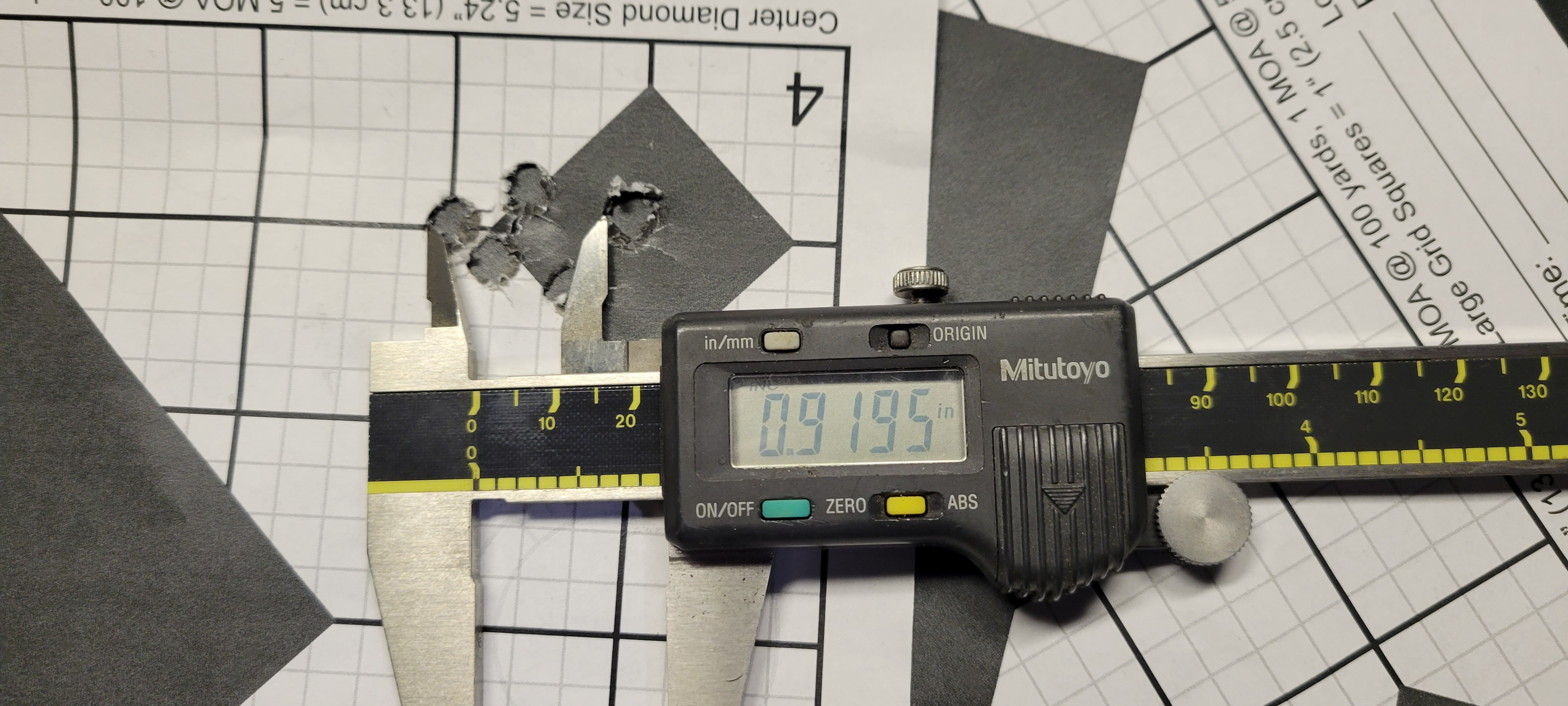

I'm a bit late to this party, but I just came back from the range today. I managed this once it broke in. I was using PMC 147gr @100 yards. I'm going to start exploring what hunting ammo to use for bear this spring in the next while.
