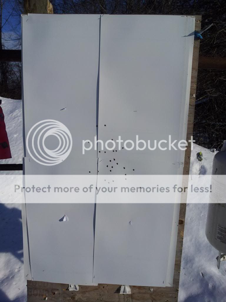

Rifle: Tavor Tar 21 (5.56) Bone Stock
Ammo: Norinco yellow box .233 Head stamped CJ 93
Distance: 275 Yards
Shot from bipod on bench
Weather 0 deg. no perceivable wind
I brought out 50 rounds.
10 rounds to sight in.
I did one 10 shot group, looked at it got mad and started over.
I did a straight 29 shot group. 1 round was fail to fire(1st one I have ever had in 1000 norinco fired in Tavor. Big dent on primer)
Size of 29 shot group = 4.1 MOA
Distance: 275 Yards

For that group, Optics or irons? How big is the group? I get that you said it was 4moa, but how wide did the group measure at it's largest point?
Edit: Or does "Bone Stock" mean irons???
I missed that the first time
Optics or irons?
sorry i was vague on purpose
I used optics
bone stock ment no changes to rifle ( especially assault trigger) blaxsun is right. trigger is a major stumbling point.
I wanted to show pics and go in to extensive detail, but I havent figured it out yet...thank you for posting my pic evolture... how?...
I think irons for me will be 20 moa...
I used optics
Given J996 has been doing this with his Swiss for thousands of rounds, and you said this is your first time shooting at this range with your Tavor, I think your group looks pretty good considering.......
REVISED
His group he said was 14 rounds, prone, and measured about 7" at 300yds, yours is 27 rounds, benchrest, measured at 8.5" at 275yds.
Like I said before good grouping :D
