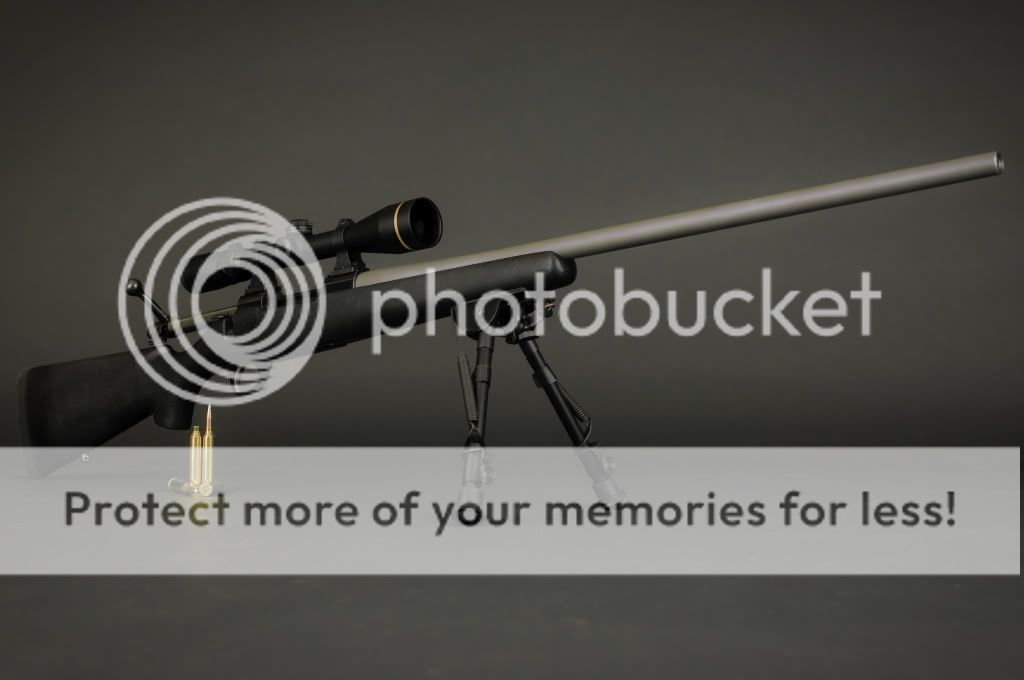

6.5-300 Win Mag as it sits now.
Here are some updated photos of my 6.5mm-300 Win Mag. It now sports a 4.5x14x40mm 1" DPLX with CDS. The stock will be painted in a spiderweb paint finish in the new year. I may have the barreled action powder coated also.
