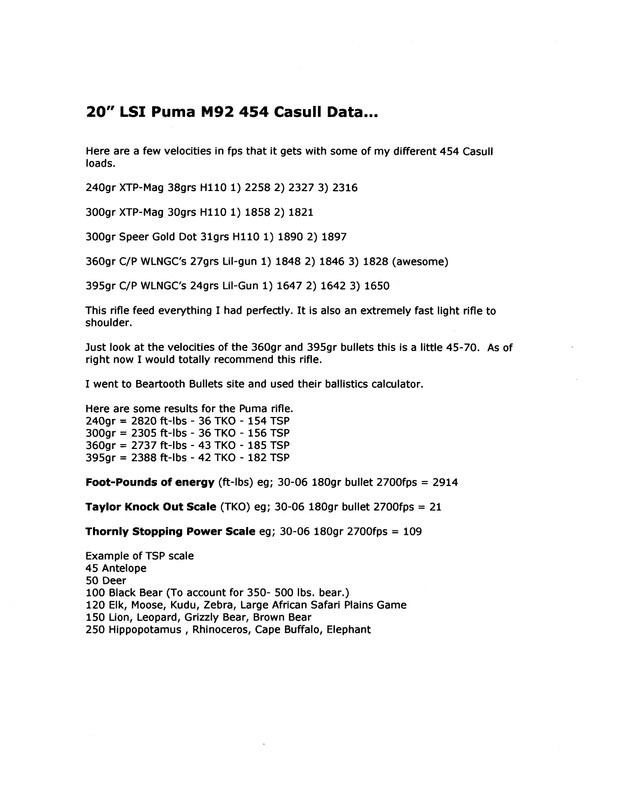

Figured the data was self explanatory but I'll try = velocities are from 10' in front of muzzle shot over my old Shooting Chroni chronograph I now use a LabRadar.
I honestly haven't read many...so don't recall the format / layout of how the info is displayed. looks like several velocities from a batch of several shots?
Hope this helps
First bullet entry is a 240gr Hornady XTP-Mag bullet then grains of powder next is type of powder 1) is first shot = velocity of 2258 feet per second 2) second shot = velocity of 2327 feet per second 3) third shot = 2316 feet per second

I did this a few years ago
I like the break down. I honestly never realized how much more velocity/energy the 240 gr were getting. I've just been casting up powder coated 300gr FP or using 300 xtpmags for all my 454 loadings. Guess I'll have to go play now....lol!
