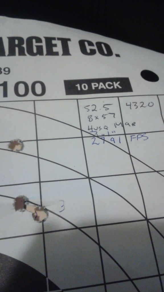

So I went to work on my loading bench, looking through my loads I have used in the past and a few new loads from loading manuals. I tried 49.5gr of IMR of 4064 with the 170 speer going 2580 fps in my Husky with a 23.6 inch barrel. Accuracy was fine off the quad seat and with a 4X Weaver scope but velocity was on the low end. I then looked in a older Hornady manual that showed the 170gr at 2800fps. Knowing my rifle being capable of taking very hotloads, I decided to give it a try. Accuracy was good, ( like I mentioned earlier, resting on the quad seat and with a 4X Power weaver). I'm sure if I put my self on the bench fully rested the accuracy will improve drastically.
I tired the loads over my Chrony and got a velocity of 2791 fps, pretty close to the book, right? Bolt lift was good and there was no signs of significant pressure. This load will be great bear medicine, and will try to harvest a nice meat bear this year. If I do happen to cross paths with a nice bear, I will post pictures of the hunt. Looking forward on a good year of hunting.

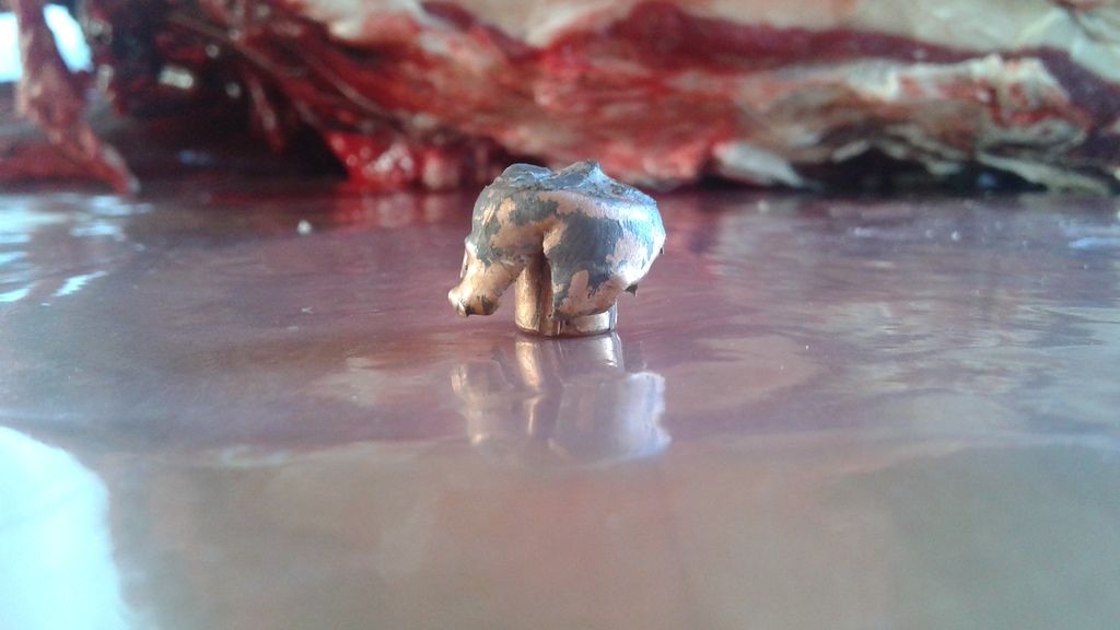

Whitetail buck taken with 200gr Speer SP @ 2540 FPS at 30 Yards. Front chest shot and bullet recovered the offside skin stuck in between a rib bone by the rear lungs .

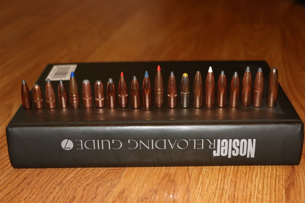

Here is a picture of most of the 8MM bullets I have on my loading bench. There are many more I'm missing like :
Hornady Match 196gr HPBT
Hornady 125gr HP
Privipartizan 139gr, 175gr, and 196gr SP
Serria 200gr match HPBT
Barnes 180, 200, 220 TSX's and 250 SP original
Many Variations of Woodleigh bullets
Nosler 180 E-tip, 200gr Match
Swift's, NorthFork's , Norma's, Matrix's, Sellier and Bellot and Lapua's
Left to Right:
150 Serria SP
150 Hornady RN
150 Hornady SP
150 Speer SP
160 Barnes TTSX
170 REM RN
170 Hornady RN
170 Speer SP
170 Hornady SST
175 Serria SP
180 Nosler BT
180 Hornady GMX
195 Hornady SP
196 Norma PP
200 Woodleigh PP
200 Nosler Accubond
200 Nosler Partition
200 Speer SP
220 Serria SP
220 Hornady SP
250 Woodleigh RN
What more can a guy want?
