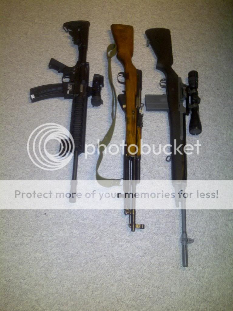

OK, sue me, one is a .22 wanna be. But the other two are all business.

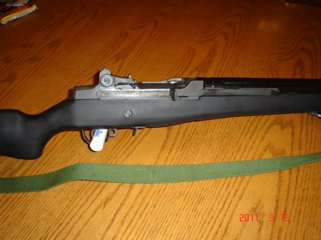

Why is this being hashed out again? I thought it was done with...isn't the thread supposed to be showing off stuff? My semi-battle rifle (two have the sporterized stocks, but are great shooters) collection

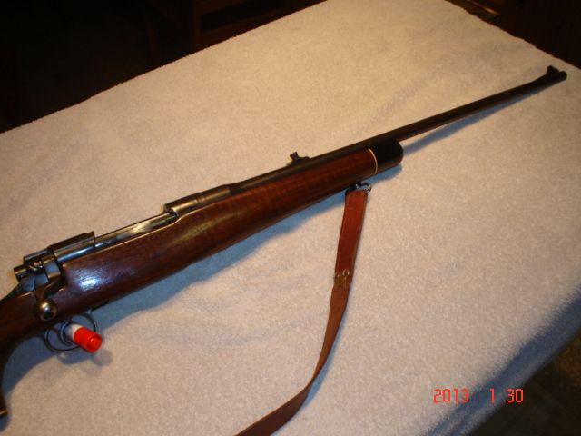

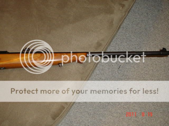

Old Eddystone Action - really good - ignore the sporterization.

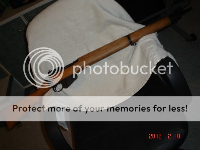

'54 No.4 Mk2

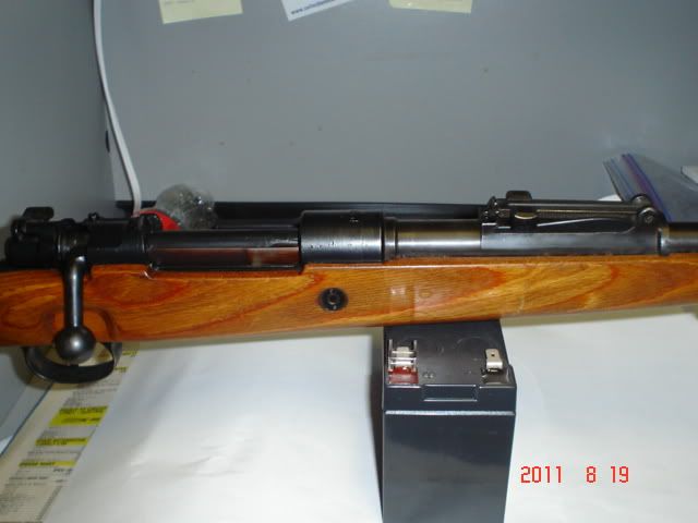

Sportered stock - K98 - all markings and waffens intact.

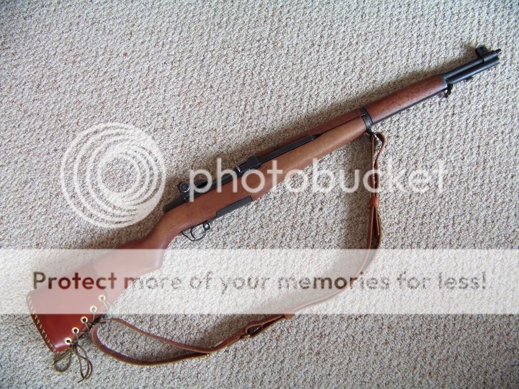

1944 Springfield Garand

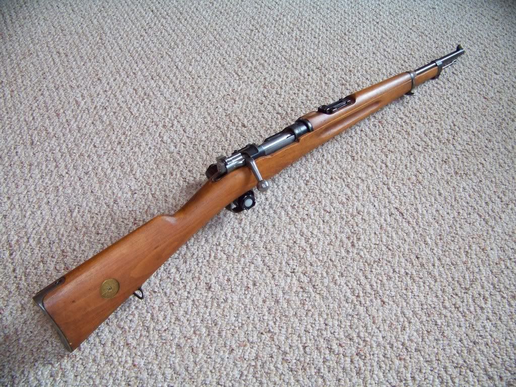

1899 stamped Swede M-38 Mauser

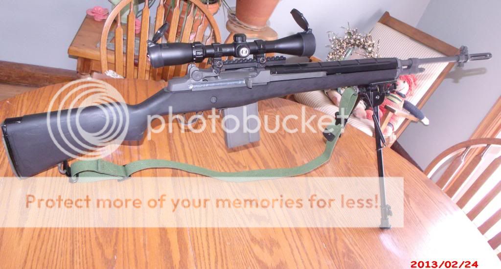

In respect to the thread, here's my not yet complete all TRW M1A, "Big Green"
