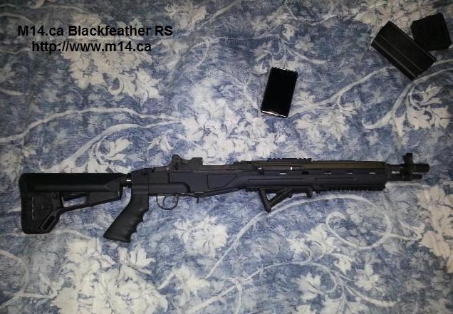

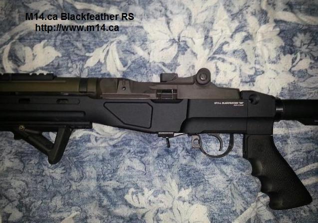

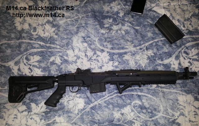

The Blackfeather "RS" and an M1A SOCOM II; an agile, fast handling, lightweight rifle running irons.
Build List
M1A Socom 16 with 4lb trigger job
Blackfeather RS stock
Magpul ACS
Milspec buffer tube
Hogue Pistol Grip
Magpul AFG2
G.I. National Match spring guide
WOWOWWOWOW! nice. Let me know if I can make something like that sometime with your help. I assume that's a "real" M1 socom II. Very rugged and I bet it's tough as nails.

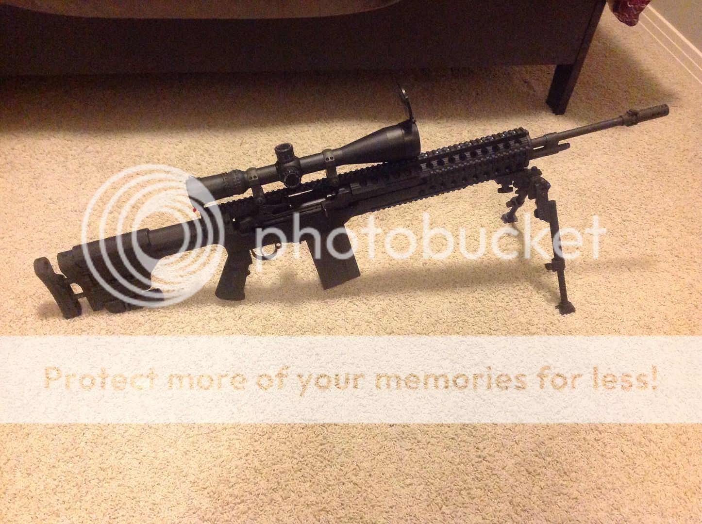

Hey all
So just finished my EBR build
Its a Springfield national match
Leupold 6.5-20x50 LR/T
Sadlak Airborne scope mount
Took alot of money and time to put together but defiantly worth it

Wow, there are 2x very nice rifles. Well done lads.

If I was "scanning for the bad guys" I think I'd be using that EBR, but what do I know?

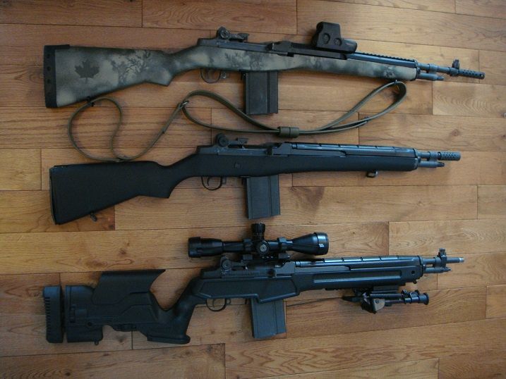

My 3 Shortys
They show 3 ways to get a M305 with your barrel at 18.5 inch's . Two are factory versions and one is done by cutting a 22 inch barrel down and then rethreading the muzzle.
Top – Factory Norinco Shorty 18.5 in barrel ,Ultimak front rail , Eotech 511 red dot , USGI fiberglass stock, M1 Garand rear sights ,
Turner Saddlery sling, Springfield Armory muzzle brake , Unitized gas system , Rauch op rod spring guide
Middle – Dominion Arms Socom 18 (my newest addition)The first Socom I received looked great but jammed consistently while feeding....
Exchanged it and ... Very poor quality control on this build. All the old problems showed up again on this one.
And this was a replacement rifle on top of it all ....ouch.
Its missing the gas locking ring with front sight in the pic as they still make some with the sight base milled at an angle ( DUH ) . New one on the way.
I need that barrel vice of Barney,s as well because the barrel is over indexed too. .
So for now I installed an ordinary gas locking ring so I can test fire it tommorow.
After that gets that out of the way a set of Garand sights go on because as usual the rear sights are junk .
Then a new op rod spring guide go on and the barrel gets peened to tighten up the guide.
The tail of the gas piston was rubbing on the inside of the gas cylinder a bit . I had to smooth the surface just to get the piston to drop and to pass the tilt test . Firing a few rounds through it probably would have done the same thing .
Good thing I enjoy working on these ....
Not sure what stock I want to put on it yet .... CQDF (Close Quarter Deer Fighting ) comes to mind ..lol
Bottom – Norinco M-305, Promag Archangel stock ,Arms 18 scope mount. Arms 22 rings with throw levers , Bushnell 10 x scope ,
Gas locking ring with front sight, Harris bipod , upgraded the op rod spring guide.
It was a 22 inch barrel version and Doug at Ellwoods cut and recrowned the barrel to 18. 5 in long Then rethreaded it to 28 TPI x 50
I still need to get a muzzle brake for it
