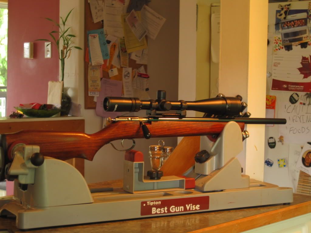

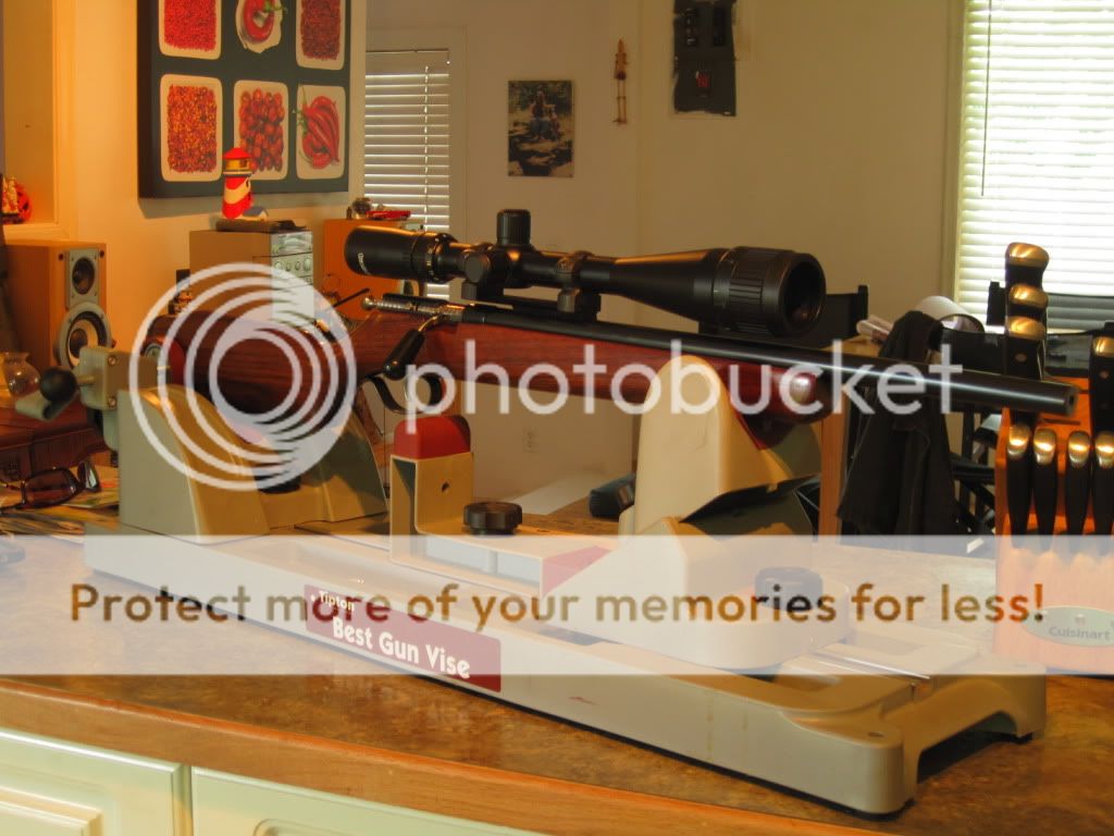

Wow, That scope is wearin' a gun!I posted this earlier(post 15) before I had re-finished the stock and rust blued all the metal so here is an update on the final outcome.

Bought the metal parts: All rusted and almost no blue left. Sanded everything back up (followed a lot of advice from midwayUsa's youtube videos) with 200, 400 and 600 grit wet sandpaper. Then used steel wool 0, 00 and 0000 and finally gave it a good polish. Then cold blued the metal parts.
I tried making several handmade stocks for it...then finally gave up (I came real close to making something nice though. Best suggestion ever: Practice practice practice on CHEAP wood) and purchased the original stock. Removed the original varnish, sanded everything down and put 3 coats of watco danish oil. Looks real nice enough thought there are still some slight bumps on it. Drilled and installed swivel studs.
Unfortunately, I sold the rifle just recently. It shot GREAT (we had a fun afternoon of plinking clay pigeons mounted in trees around the camp and it was hard to miss any of them, even when they were super far away). The rifle was just too heavy to lug around in addition to my moose hunting rifle (it was mainly for grouse).
Before:
After:
