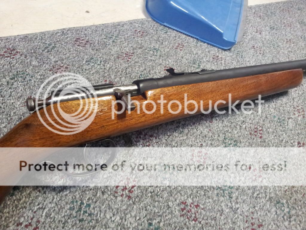

First one was just bit neglected and rusty.Mechanically excellent. I Picked it up from acquaintance alongside some other "junk" as he called it. It really had potential. Bore is good and was only buttplate that needed to be changed. So in few days of work here it is...
Second was a find at a local gun store. Cheap...i think but needed take down part, rear sight which i still need. I bought it to restore for my 4yo niece who happens to like guns. First thing i did was taking it apart. I needed to invent a take down that was easy to use and somewhat original. I removed the weird screw and washer and then the part below that is in the receiver. I had old threaded rod and trigger guard form model 60. removed the nut from the guard and shortened the rod. Drilled the stock larger and installed the parts. Then rest was simple. I cut the stock. re worked the plate to fit, true oiled it and did cold blue job on the rest. I am happy with the result. What do you think? I imagine i will get another one if it comes around cheap enough...I Like the little gun has original 16" barrel and its so light. With cut stock it has got perfect balance...
here is some pics...
canuck jr

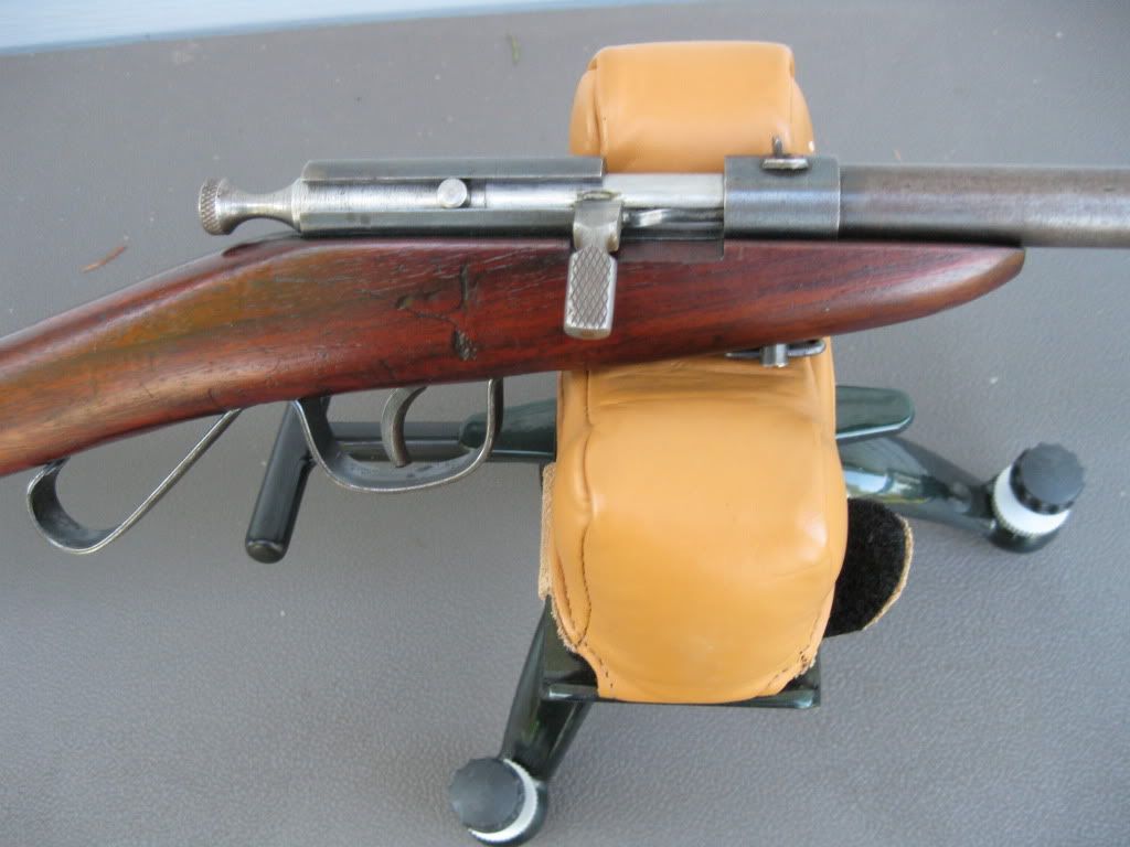

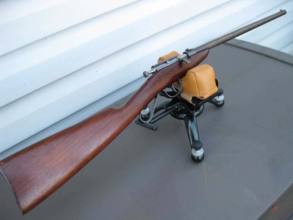

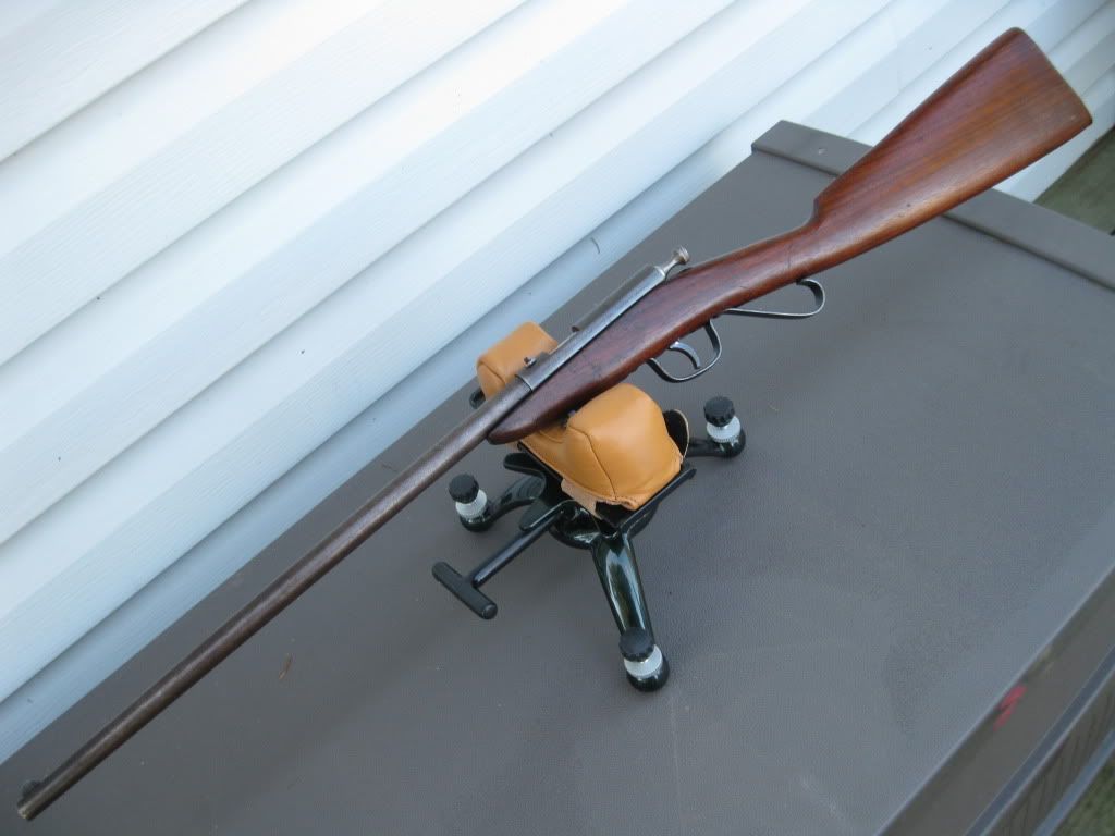

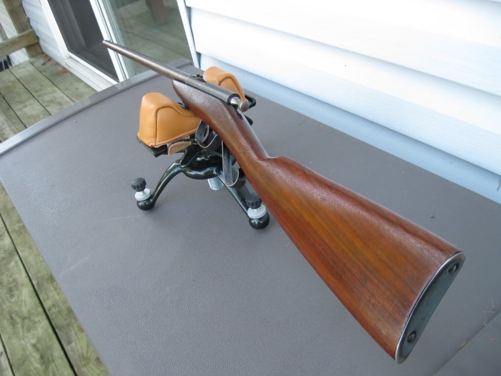

both my sons learned to shoot with this little gun when they were 4-5 yrs old.now they're in their 20's.so i thought i'd get it ready for some grandchildren,someday,maybe.
here's a couple of pics of mine

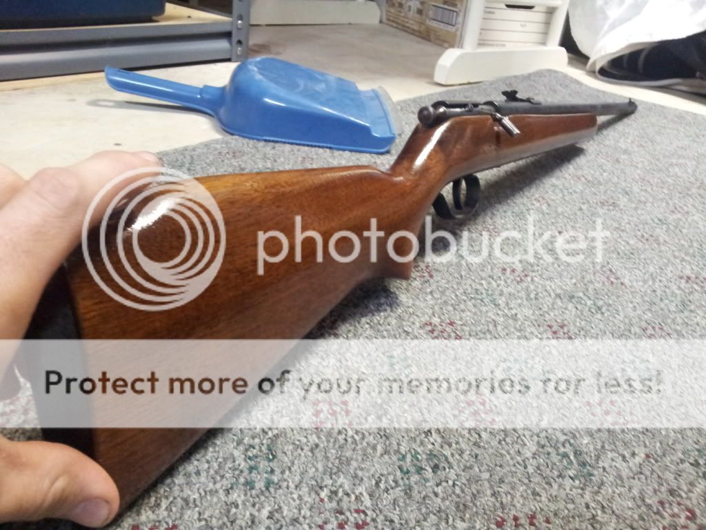

Tried to blue it mnay times and failed everytime.. Just bought some high heat spray and coated the barrel with it..
Just didnt do the bolt itself.. The wifes grandpa must have grinded the bold down for some reason many years ago as its nasty.
The gloss look wore off me quickly..
Wont be doing that again.
That's a newer 39(prob says winchester on the plasic butplate). The more squared off design and plastic trigger guard also add up to the same period. The older ones have metal trigger guards and butt plates and the pre 55( have to double check) ones will have blade type screws in them instead of philips.
