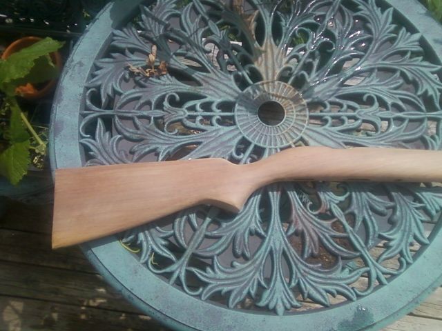

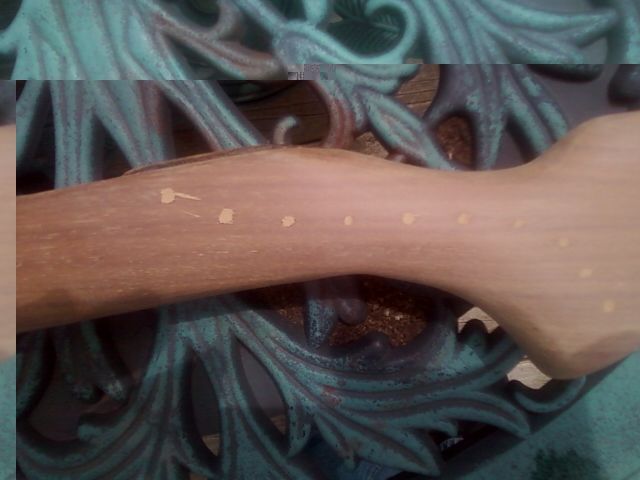

The stock I did myself - I've redone stocks many time, but this is the first one where I changed the colour. The stock too me weeks to do - after carefully refinishing down to 1000, I lightened the wood considerably, which was a multi-step process I did 4 times. once that was done, the colouring was a painful process, and I'm not 100% satisfied with it, but it wasn't going to get any better. Some areas you can see it is a little blotchy, and it also collected in gaps. Near the cheek weld there is what looks like a knot that was drilled out and filled with dowel of a similar wood. The job was done nicely, but the tiny gaps collected stain. I was going for a "hi-lo" colour job, and that part turned out not bad. Finally, it is finished with Lin-Speed (the best wood oil I've ever used) using their prescribed 'dual finish' application, which I did 3 times - that was more than a week in itself. I finished it with 0000 steel wool to give it a satinization to match the metal work, and the finish turned out great. Luckily, it was a fairly nice piece of wood, and a lot of character was under the old dark colouring.

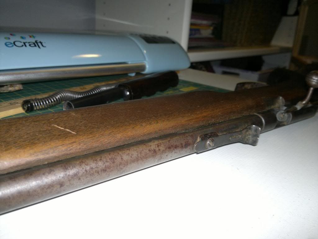

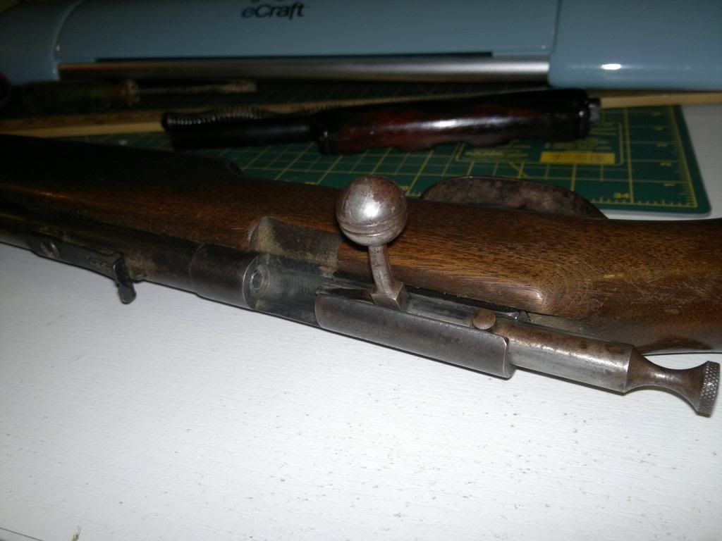

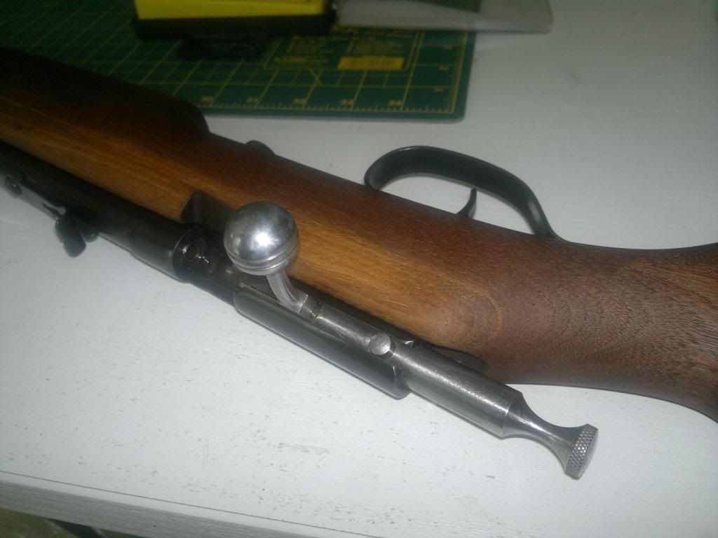

I bought a cooey 600 on the EE. Suddenly I got two other cooeys by donation. These are all older. The first is in very good shape. The 60 is similar to the 600, but is rusty and the wood has a few dings etc. I also got a 75, which seems to have a much longer barrel than the repeaters. I plan to de-finish em fully, re-blue, and re finish the wood. I paticularly like the 75, and the 60, because they are likely pre Winchester era, and the. quality of the wood stock seems better.
I don't mind the cleaning process, it is kinda fun cleaning them up, and restoring them to their full glory.
They say they are pretty good shooters. Guess I will find out.

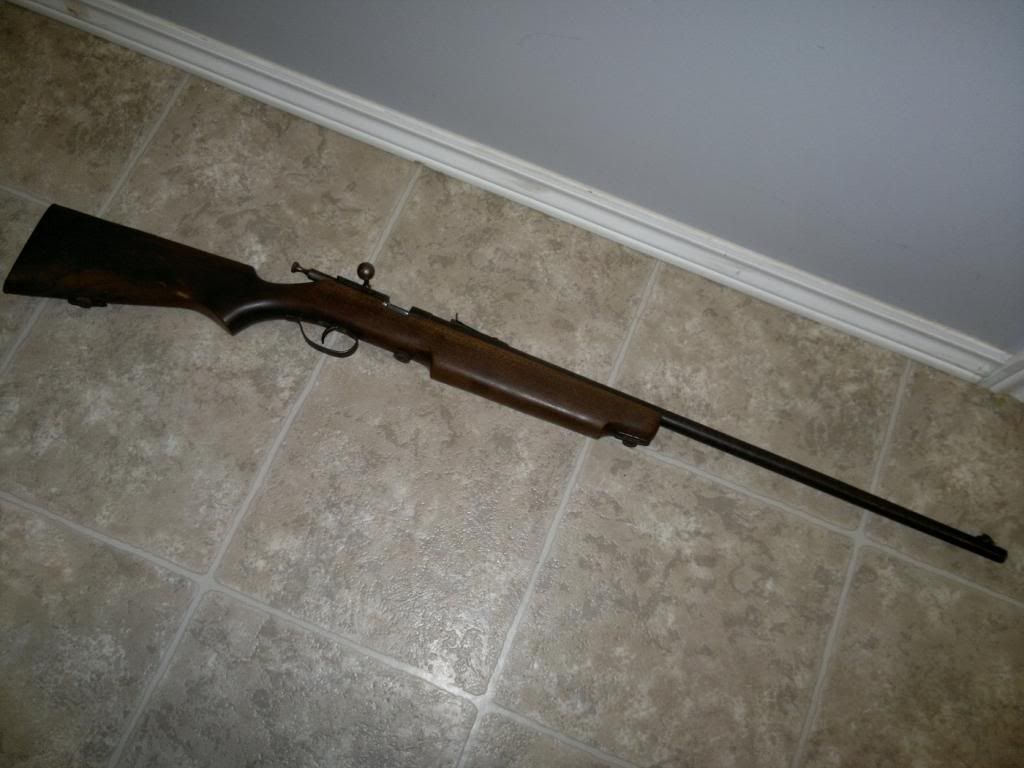

here are some pictures of what it looked like when I got it.
As you can see it was in bad shape :( When I started to strip the stock I uncovered that the stock had been sanded with a belt sander and that there was some nasty marks on the wood.

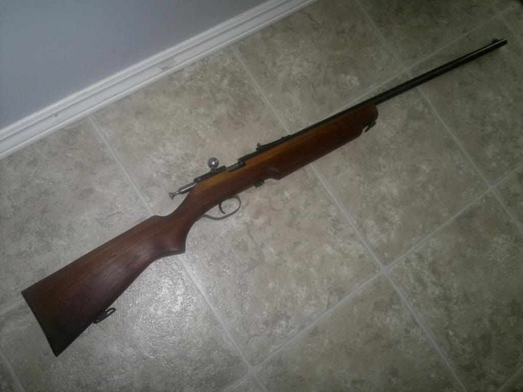

Next was the color of the stain and I wanted a reddish colour. We decided that it would look nice in cordovan and here is the finished rifle.
My wife absolutely loves how this turned out and cant wait to take it out for some plinking.
For me, it was a chance to take something that was not wanted, and turn it into a beautiful piece of art. This will forever be a reminder of something that was made in Canada and of my father who I love very much.
That is a fantastic looking job of carving. Woodwork like that is hard to pull off, and unforgiving of mistakes.
Beautiful, classy looking result.

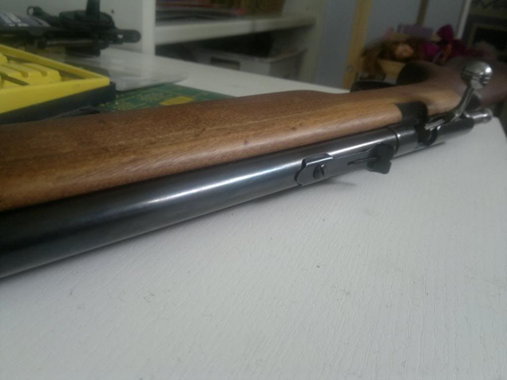

I cleaned all the rust off the barrel and re-blued. Cooeys seem to be very simple designs, but very good designs.

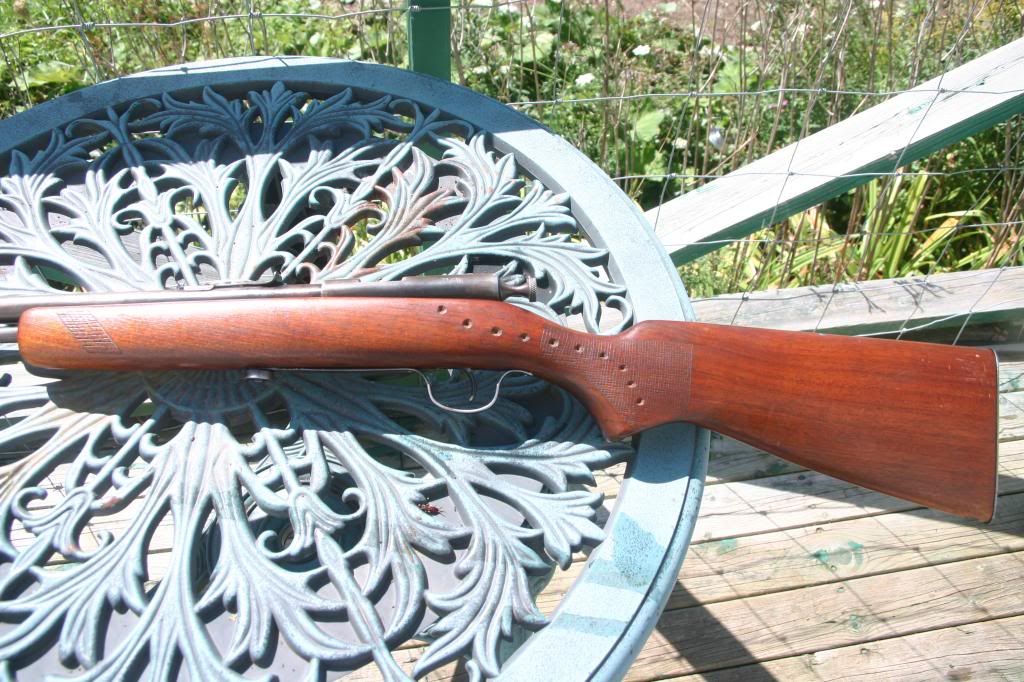

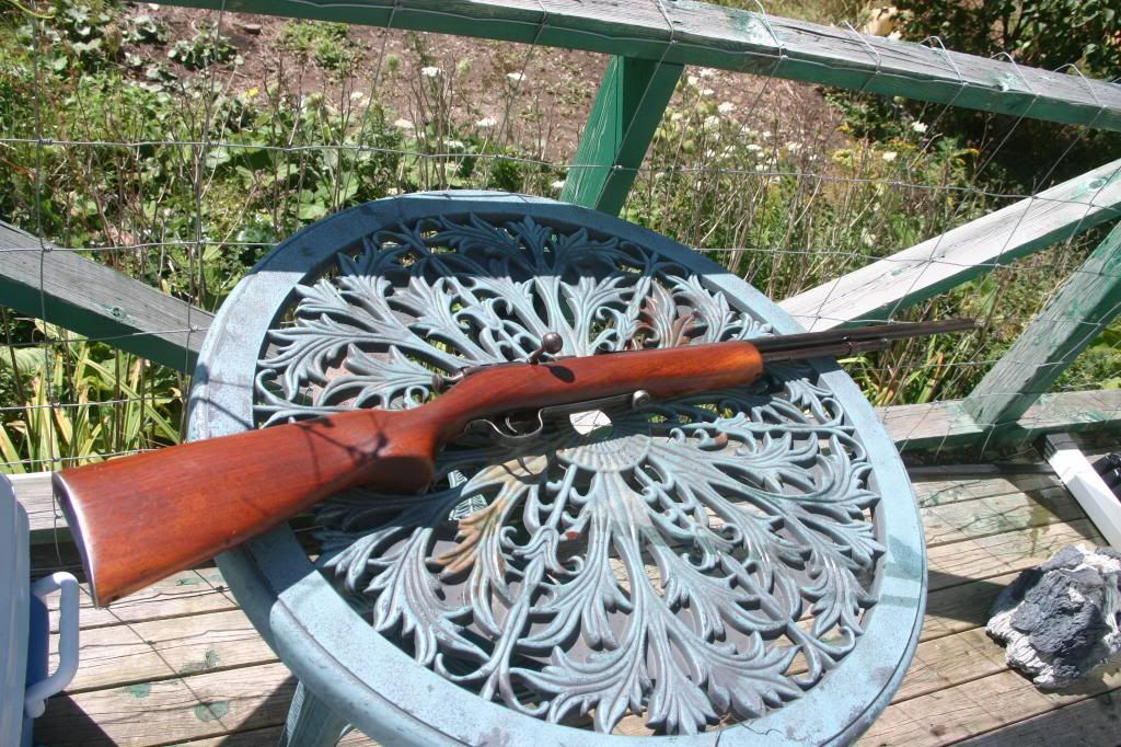

I've had this gun for a year now and decided to do it over but I have come to a road block on the stock. One of it's many owners cut holes in stock and I am stumped as to what to do next. I thought about filling them and painting the stock one solid colour, but I like wood. any suggestions.
Check EE Rimfire Parts forum for a new stock.
