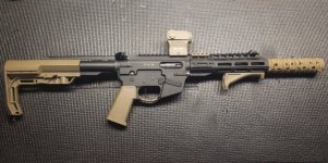

Any muzzle rise using these?Both have the Armanov comps . View attachment 854427
I will leave this here. My suggestion is an up ported comp whether it be the madcow one, a Davinci Diesel, an MBX, or the Tandemkross Game Changer. We have done testing (a bunch of us)... they work on all lengths of barrel, just more so on shorter barrels.What you want is a compensator not a muzzle break
1100fps 131 grain bullet, the dot doesn’t mive
