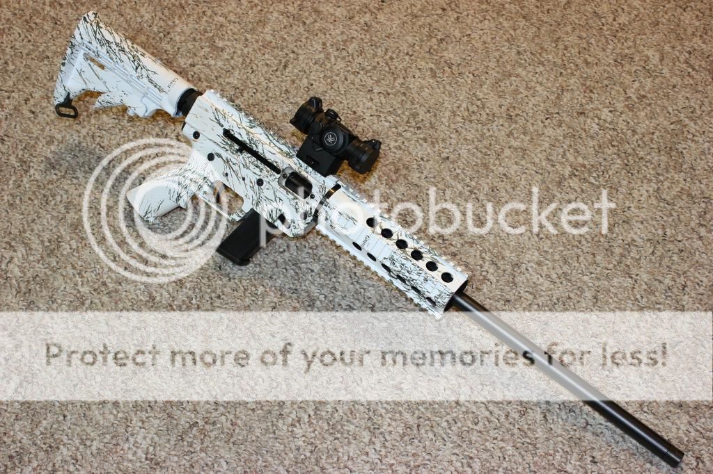

I am in the process of mounting an ATI octagonal forend on my 9mm; it's just under 12 inches long and although I'd like to have gotten something a little bit longer, it looks a 1000% better than the stock one.
One problem that I have to resolve though; since the forend is slightly smaller in diameter than the stock one, it came with a new barrel nut to secure the barrel and for end. The problem is the threaded part that attaches to the front of the receiver and captures the lug-ring around the barrel has a small amount of excess threaded material; even torquing the nut down to 35ft-lbs ( the recommended max) against the receiver doesn't snug it up tight enough to securely hold the barrel.
I'm hoping some of the experts here can recommend the best way to fix this; I can see two options; cut or grind down the excess material on the face of the barrel bolt to allow it enough room to properly snug down and tighten the barrel, or try and find a washer or a crush washer the right size to back up the lug on the barrel and shorten the spacing up that way.
Does anyone have any suggestions/ideas to resolve this? I hate the idea of going back to the old look and feel of the stock forend. The ATI feels a lot better; eight sides with rails mounted only where you want or need them and smaller diameter overall is MUCH nicer to hold. I'm positive once I get the barrel snugged down properly it's going to be a lot nicer to shoot too. I suspect it'll be easier to reduce the length of the barrel nut than find a washer the right size, so that's likely the route I'll take unless someone has a better plan
go to an auto parts store and look for a drain plug washer. a crush type. VW DSG trans works almost perfect. place that between the nut and the flange on the barrel. tighten down like normal.

second that. Any forend for an AR fits, but you will likely have to do some additional shopping to make the new forend work. l am quite impressed at the ATI system both in appearance and price. The octagonal cross section makes it quite slim, it's nearly round, and very comfortable to hold. Unlike a lot of aftermarket forends, It also comes with a new barrel nut, and three different lengths of rail to attach. A little fooling with it and GTG
Got the 9mm, just need to range test it now
How long is that shroud? Just ordered my JR and would like to get a shroud on order before it shows up.
Looks awesome.
