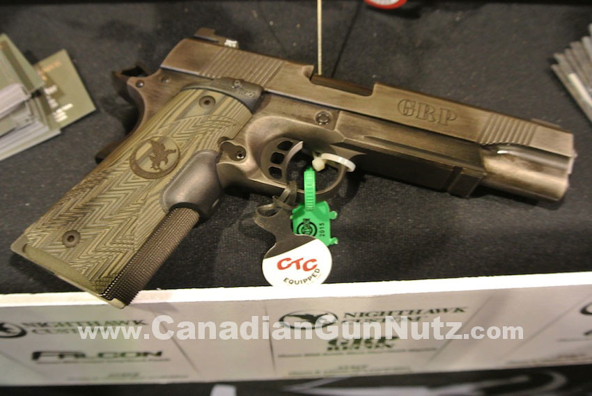

Nighthawk beat them to it with this poseur special :p
Except, of course, they omitted putting wear on the grips.
Is it just me, or does this Nighthawk look like unwholly sh1t!? I can't imagine anyone aspiring to this kind of finish particularly on a high end 1911 like NH or Les Baer. User wear is one thing, but to start out with a finish that makes the gun look all banged up is just stupid imho. Sad day when a Norinco "looks" better than a Nighthawk.

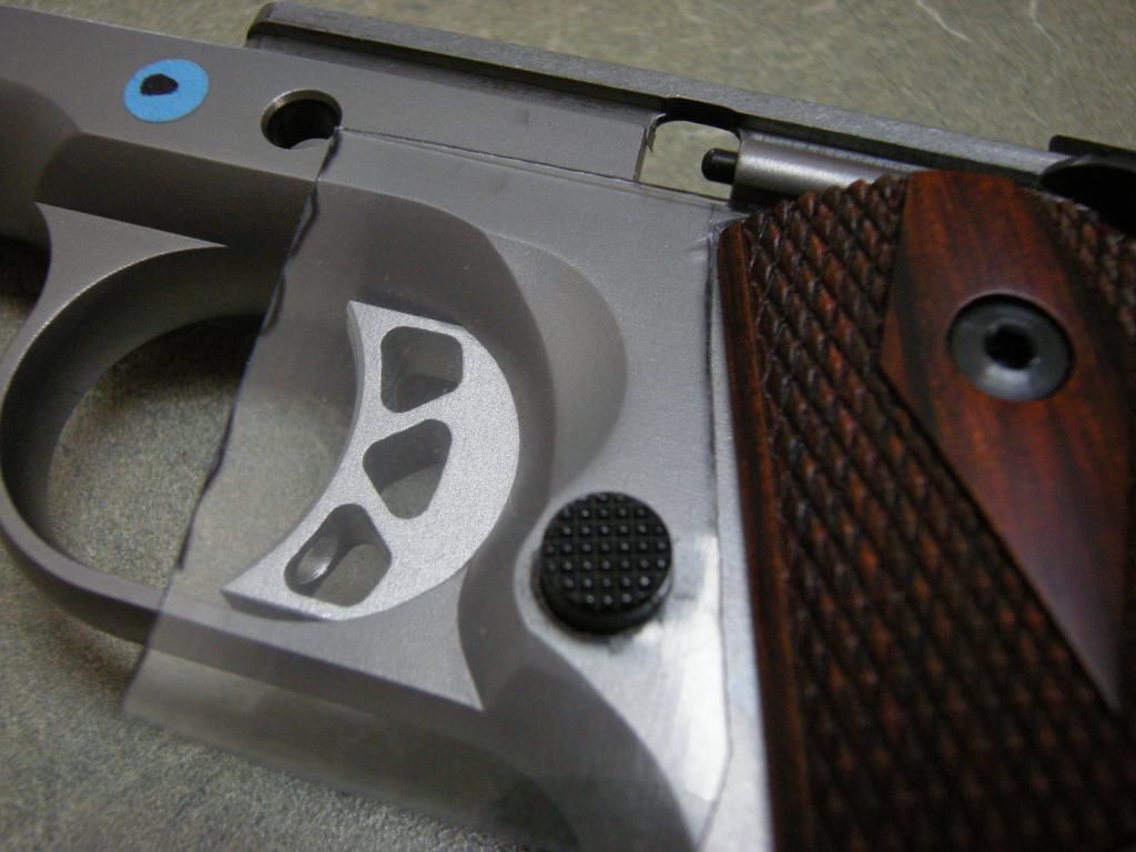

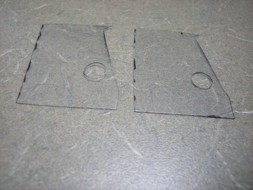

If you "need" to...... With some standard hard plastic packaging material, a sharpie, ahole punch, a pair of scissors & a few minutes of time you can make yourself a handy-dandy idiot scratch prevention tool:
Easily slips on & off for disassembly & reassembly. Prevents the underside of the rear of the slide stop from scoring the frame.
Too late for many of the 'oldies' but worthwhile if you've bought a spankin' new 1911........... ;)

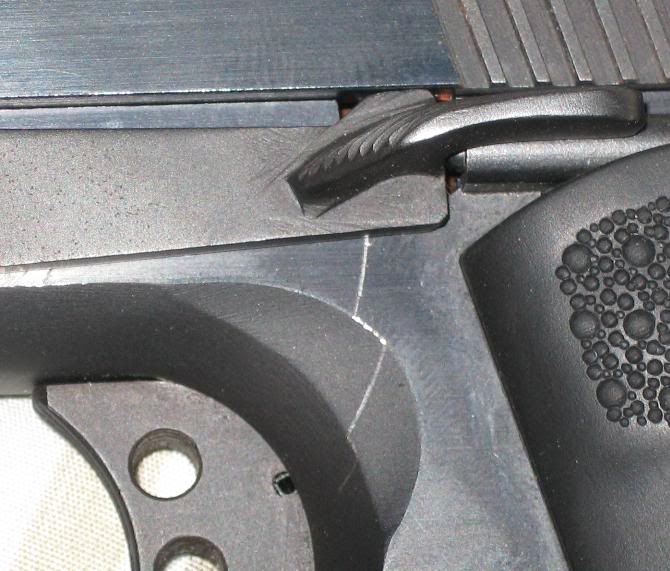

I just cant understand when people have the scratch going radially down to the trigger. It shouldn't be called an idiot scratch, more of an incompetence scratch.
to cause something like this, this guys shouldn't be trusted with a loaded firearm
Before I recived my first 1911 I thought maybe it's hard to put together. That's why so many of them have this scratch. Not wanting to judge before I tried it myself. Now I know that they're idiots.
A nice trick to avoid it, take out the spring in the plunger tube assembly and remove a few links on the spring. lessons the tension and allows the slide stop to pop in easier.
