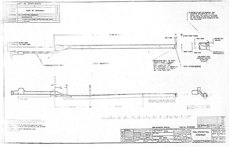

Yeah, that one is either damaged (bent) or was modified for some other bbl config IMHO. I'd exchange it if it were me.
By the way, if you have a gas cylinder, try the one that looks off with the tip inside a mounted gas cylinder. It could just look off from your camera angle.
There are actually 2 varieties of op rod bend profile. The late 77 rods are more dramatically bent to more closely follow the base of the barrel, a mod that came out of NM lessons learned at SA. Depending on the drawing numbers, it might be OK that yours are different than one another, but you need to mount the op rod in a cylinder to see if it will work or not.
Will index the barrel and try that on monday :)
