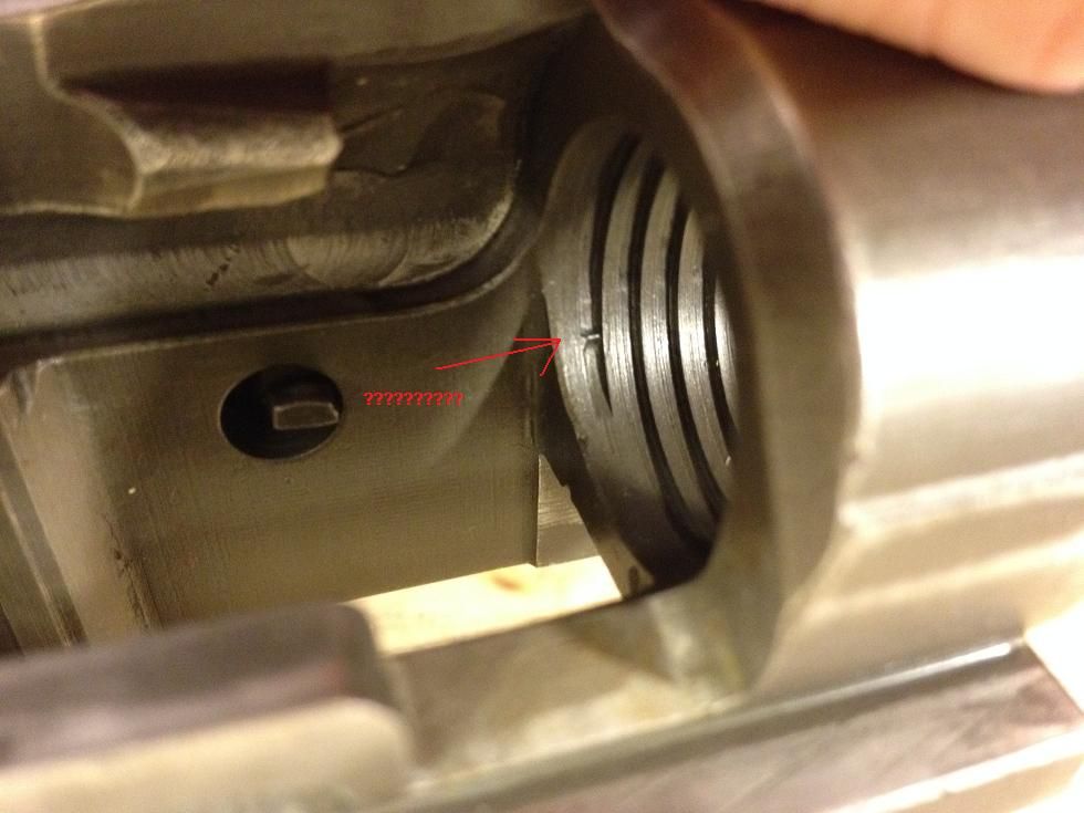

Just noticed this on my receiver, a ridge across the valley right at the end of the barrel threads. Is this normal? Total Garand newb here. Thanks!

The bur in the above photo of the receiver thread should not be an issue. I think it's far enough back that the barrel threads won't get there.
