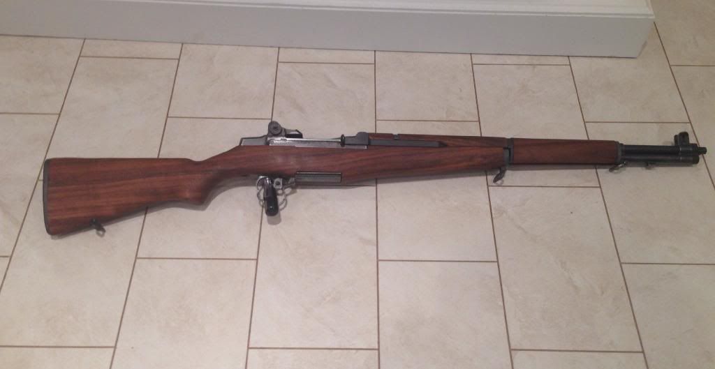

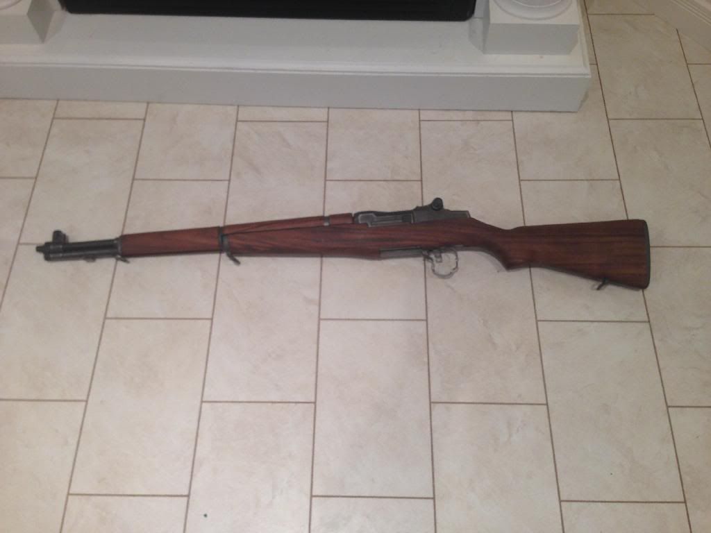

Current progress.....
Two 308 build buckets....
Rough assembly with hand turn of the barrel (off 360 degrees obviously)
The stock is soooo tight. I have to do some sanding I think. I can't get the trigger guard to close at all.
Test fired mine today.
It's accurate, shoot well. But it fails to feed a round in the chamber. As if the bolt wasn't going all the way back.
I was shooting 168gr Remington Core-lokt. With an adjustable gas plug with the smallest plug screwed in.
Op rod was also rubbing on the wood while firing.
We were shooting 1in groups at 25yards sitting.
