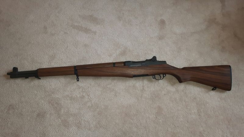

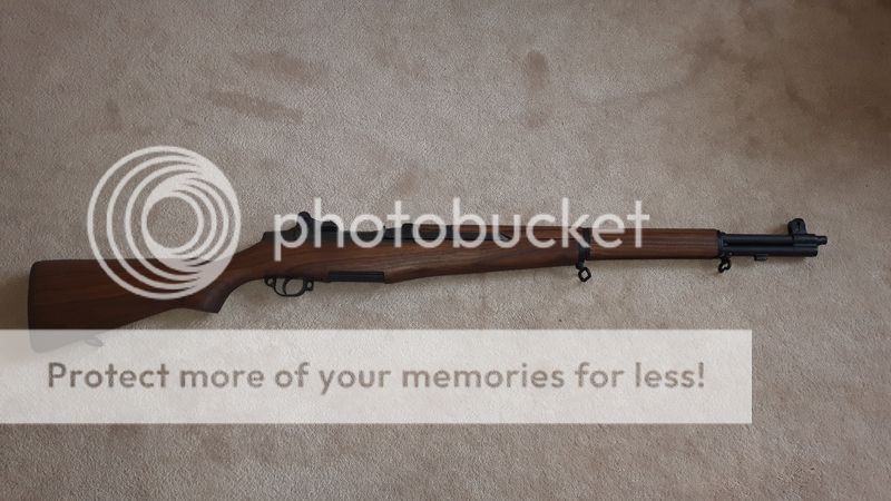

Finally my third is complete. It is a Breda model on a walnut stock. A big thank you to member Beretta Armorer for helping me out with the barrelling, parkerizing and a few parts. I would like to do just one more build, but that is what I said about the last one. It is a lot of fun piecing these guys together, although at times a bit costly.
[/URL][/IMG]
'43 Springfield on the left and my Breda on the right
[/URL][/IMG]
