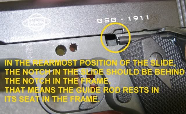

Now it's time to check your work.
Move the slide all the way back.
Look at the notch in the slide and the notch in the frame.
In the rearmost position of the slide,
the notch in the slide should be slightly BEHIND the notch in the frame.
If the above is what you see on your gun, then continue to
re-assemble your gun and you are good to go.
If however, with the slide in the rearmost position,
the notch in the slide is slightly IN FRONT of the notch in the frame
like in the pic below,
that means the end of the guide rod is hanging on the shoulder of
the barrel, and you do not want that.
If the above happened, take the slide out, re-position the guide rod against the barrel lug and try again.
Once the guide-rod rests in its designated seat in the frame,
there is no chance the gun will break the barrel bushing.
