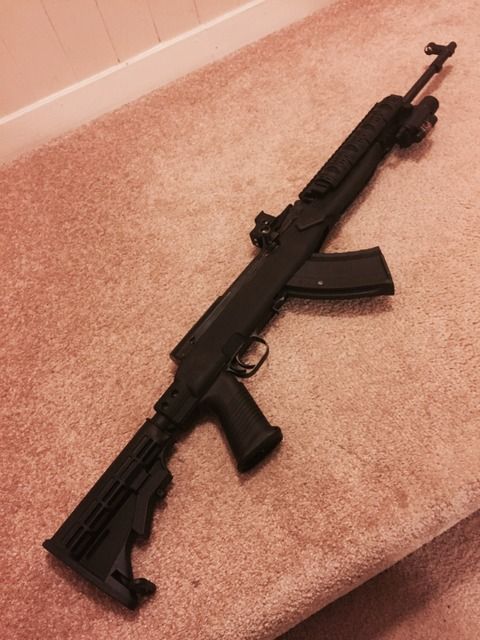

Well Here is the build thus far, all the cosmetics and furniture is on, Barrel will be shortened down to about 18.7 - 18.8 Inches. I'd like to find a better optic to go on it maybe a set of flip up sights. Can't wait to try it out, the only problem i had was the top hand guard that covers the gas piston won't fit because of the built in rails on the top. I am not sure if that will affect anything when firing the rifle. I tried looking for anyone who has tried but i can't find anything.
[/URL][/IMG]
Thus far build is Tapco SKS stock with ATI adjustable But stock with cheek comb with UTG quad rail, with a Matador sks shell deflector/rail and an IMI defense fore grip.
Hope you guys like it!
Dan.

Its, not so much that it would not fit between the brakets of the gas tube where the upper handguard is. its that the quad rail won't fit with the handguard there because of the rail on the tapco hand guard (not easily removable). I just wonder if it is safe to shoot without the hand guard there and the gas tube exposed. I can't see there being an issue but i want to make sure.
Really, the only option is to remove the hand guard. It's actually not all that hard. You just need a punch and a hammer and a nail. There's lots of youtube vids on how to replace the hand guard on an SKS. You'll just need to assemble it again without a replacement hand guard as the quad rail will serve that purpose now.
As for leaving it off, I wouldn't recommend that. It will blow gasses back at your face every time you shoot it and render your SKS a single action bolt gun instead of a semi-auto. Which is completely counter productive to the Tacticool function of the rifle.

I do have the quad rail over top of the gas tube where the hand guard used to be. The gas tube assembly is all there and together the only part that is missing is just the hand guard.
but from what i understand of your post is that it will be safe to shoot.
Oh. Yes indeed. If the tube is assembled properly the quad rail will protect your hand and anything else from getting burned.
