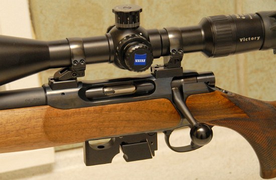

Apparently 300 T1Xs have hit the shelves in Finland. Ha anyone come across any photos of the rifle outside of he stock? I’d like to see some photos of have the magazine and mag well are set up. Bolt knob as well.
From somethings I've heard in videos, sounds like the mag well is part of the receiver. So maybe it might be kind of like the sako quad, if so this might be a good thing for chassis that take AI mags, maybe it will just sit in the AI mag well.
I signed up for RFC but am still waiting for an email to get access. I saw the pics with the Bravo a few days ago. I think it confirms what Tikka said; the T1X footprint is the same as the T3/T3X, same with the bottom metal. I’m curious about how the mag attaches.

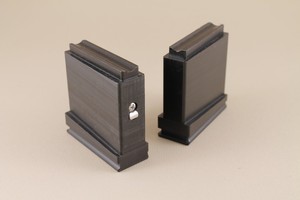

I’m planning on putting the T1X in a Bravo as a trainer. I’ve got a .308 and a .223 in Bravos as well. I’m sure it won’t be long before someone designs an AICS pattern mag that would feed the T1X in a chassis. I’m sure the demand is there.
Sounds like a business opportunity
1st. Get a 3D printer
2nd. Design/test/produce a "sleeve" for the magazine, to fit a AICS chassis
If you've got plenty of time, you could design something like Sauer did for their 202 conversion kit

Quote - 'Well that was a bit short lived. Picked it up yesterday, returned it this morning. Lovely gun but quite a few quality issues with it. Firstly the action was quite marked up with light scratches here and there. Especially in the scope rail. Something weird was going on underneath the bluing in some places. Looked to me like rust starting to come through. Magazine was pitted on one side and looked awful to me. And to top it off, the bolt was scored. Deep enough that I could hear my fingernail clicking as it ran across it. I know that this is only a £500 [Can $860-ish] gun, but I expected better from Tikka.
Anyhoo, on the positive, it’s beautiful to shoulder, light and well balanced, lovely stock and looks better in real life than the pictures. Quality issues aside, I Like it.

I’ve thought about it but I don’t have the time or skills to invest o make it happen. I wish I did as I’m sure it really wouldn’t be difficult. All you would really need to do, depending on the width of the T1X mag, is to 3D print a mold that will enclose the mag in an AICS shell. Something simple that the consumer could simply bolt together over top of the mag that comes with the rifle and voila. Hopefully someone else will come up ilwith it and I will happily pay less than 100$ for it.

Why not just print a new floor plate for the Bravo chassis that allows all unaltered T1X mags to work in it.
That would work too but it would be a fix that is specific to the Bravo while an AICS pattern mag would have much wider appeal. As well, the trigger guard / mag well on the Bravo is aluminum and the action screws go through it. I don’t think plastic would be strong enough.
How much does a good 3D printer go for anyways?
