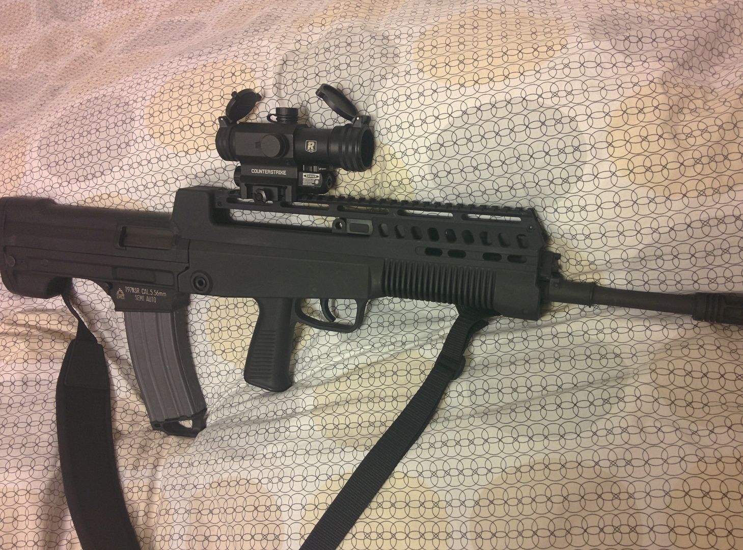

Here is my current setup: FTU with EoTech 512 and side-flipping Vortex magnifier. Have not shot it yet, but cannot wait. I really want to install a vertical fore grip, but I am terrified of damaging the handguard through incorrect drilling.

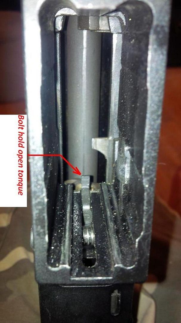

It's a small dark object beyond my ability to photograph without creating a bloody mess, so I'll try with a diagram..
What was happening with mine was that the bolt hold-open tongue would occasionally hit the back of the casing when inserting the mag and even when it's being cycled to the point of stripping it out of the mag and tilting it up, so when it gets hit by the bolt, the bullet gets jammed into the casing (check the slightest bit of interference with the back of the casing on the "bad" diagram - enough to sometimes bump the cartridge but not enough for a cartridge in the mag to actually make the bolt lock back)
What is supposed to be happening is shown on the "good" diagram:
-The tongue clears the back of the cartridge, so it's hovering just above the mag follower
-As long as there is a round in the mag, the follower will be pushed down and won't engage the tongue
-As the last round is chambered, the follower goes up, pushes the tongue, which raises a little nub that holds the bolt back
What I had to do:
-Shorten the tongue so it clears the back of the casing if inserted all the way back in the mag but can still be pushed up by the mag follower
I guess my lack of success with the SKS conversion to XCR mags project bore SOME fruit as a learning experience![]()
