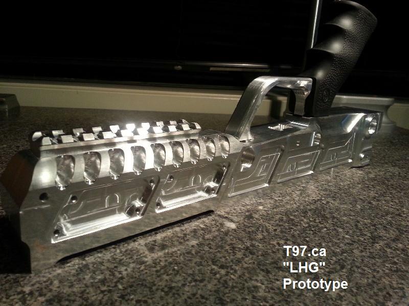

A couple of photos to share of the T97.ca Lower Hand Guard. Just out of machines today. 44 gram weight penalty over factory original excluding hand guard. The official LHG thread can be viewed here.
Picture all put together with everthing attached. Just wondering about the safety just not comfortable with a rifle I can't reach the safety with my thumb to maintain positive control of safety. I read that the new issue rifles to the pla have a safety located by the pistol grip. Will this feature be incorporated?

In a few pics I've seen AFG's and a forward vertical grip on T97's -- How are you guys attaching them?
Is there something specific I should be looking at ordering to connect up something like a vert grip or an afg? (while we wait for the t97.ca lower?)
No ones posted about how they are getting AFG's or forward vertical grips on their rifles :(
if someone finds out, can they come back and post here. I have an old AFG sitting around that would probably make the rifle more comfortable for me :)
Thanks
Zeer, you'll need to purchase a small piece of rail, 2"-4" maximum. (magpul or other brand). Fit the rail to the bottom of the lower hand guard, center it, and mark the holes. Drill said holes, and use a nut and bolt to fasten the rail to the hand guard. Attach the AFG to said rail and there you have it.
