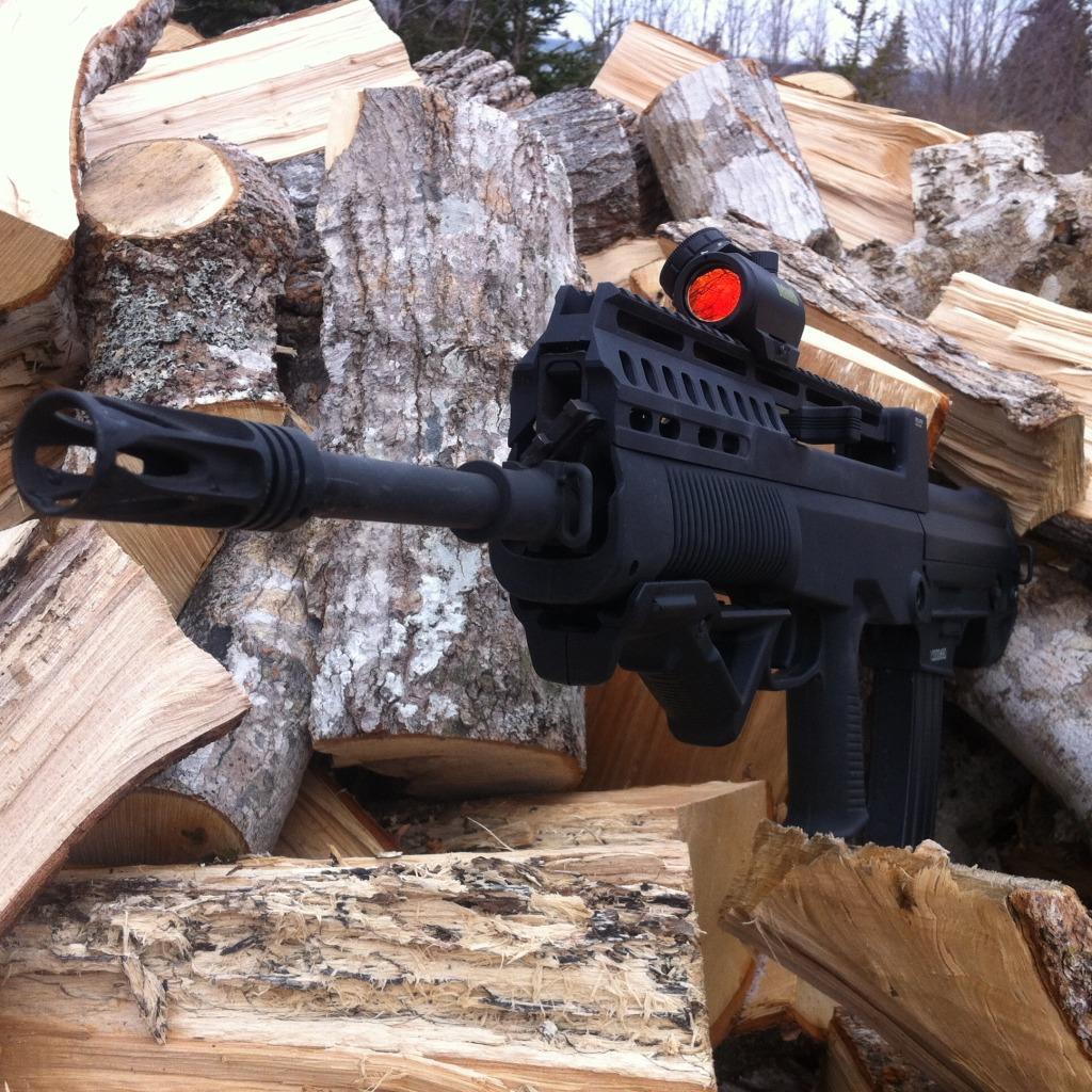

Since this is the T97 thread, PICS!
I had this scope mounted on the carry handle rail, and it was just too high. Now, I can squish my cheek in properly and it feels a lot better.
