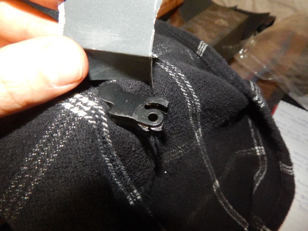

Next look up into the left grip and find the steel lever with a notch in it. Use a screwdriver to push the lever over to the left.
Pry down on the inside of the grip gently with the driver and the grip should pop off the frame.

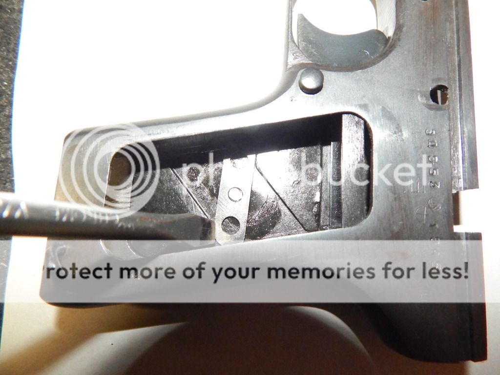

Look inside the space into the right grip. Use a screwdriver to rotate the retaining clip.
Tap the grip out of the frame with the screwdriver.

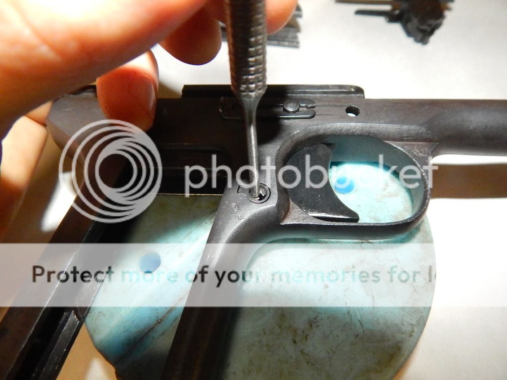

Now the trigger group, drift out the large center pin (hammer pin) Careful as there is a large spring inside the hammer, it may fly once you drift her out so cover it with your hand.
Remove hammer and long hammer sping.
Using punch drift out the sear/sear spring combo and the trigger disconnect. If group is oriented as my pics, it's the lower left pin.
Remove the sear/spring and the disconnect.
You now have the TT33 completely stripped!

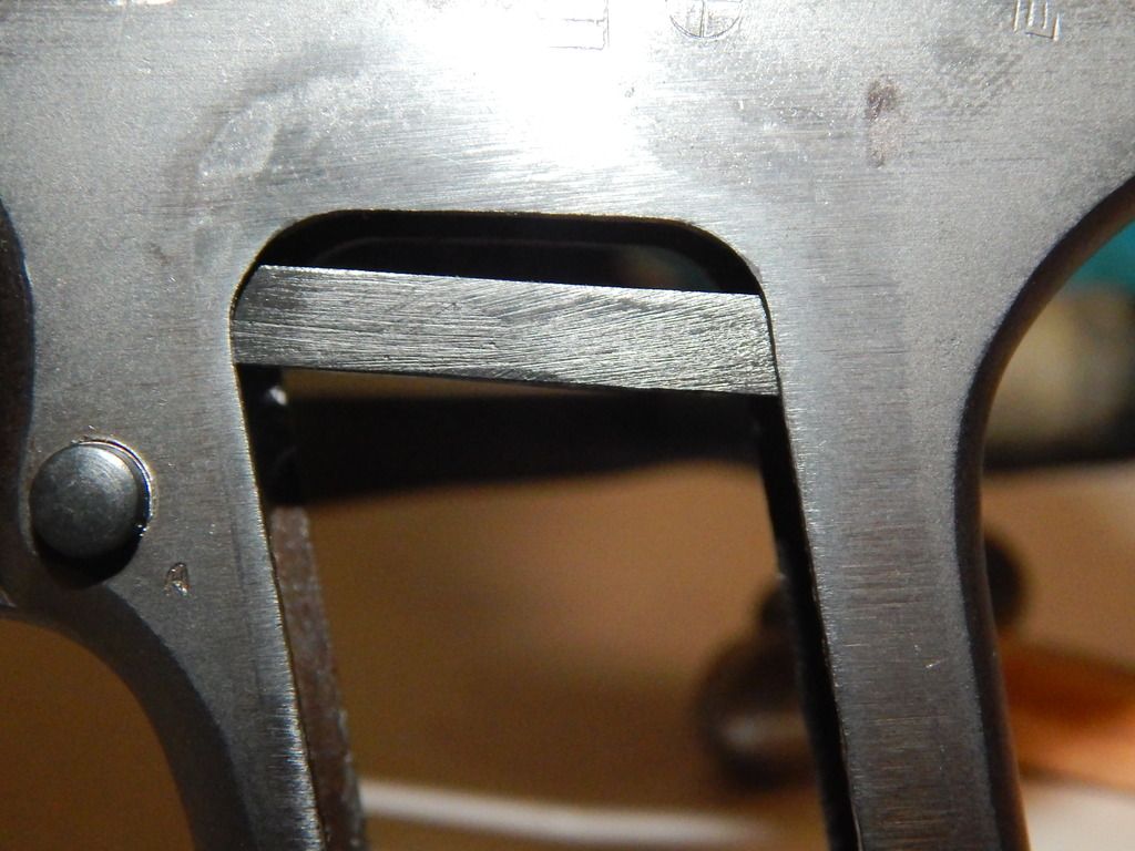

Next do the 400/600 on the bottom of the frame on the long rectangle of steel underside. These can vary from pretty smooth already to machines with a potato terrible! Years may vary!
Polish the whole underside of the slide which rides over the disconnect and the inside of the trigger group frame:

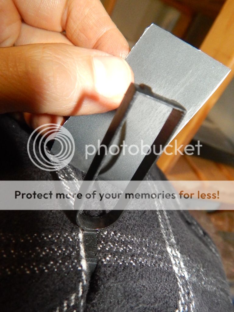

Take out your trigger again. Look inside the trigger collar, where the magazine slides up into it. Again depending on production year, the insides of these can be bent, edges can have large burrs or the machining can be very rough. Pay special attention to the rear/back of the inside of the collar as this is the area that (if very roughly made) will contact and rub the spine of the mag when the disconnect is pushing it down (slide locked to the rear on empty chamber) that's why your mags wont drop free in this state! Also can be the cause of the "gritty" feel of the initial slack/trigger pull with the old TT33!
Clamp it in a vice and go to fackin' town on the inside of that sucker with the 400/600 combo again. If it's a war production pistol I'd even take a fine file to the inside of the thing first then 400/600. Pay much attention to the inside rear like I said. Give it some extra elbow grease.
You can see in the pics how uneven the metal was inside mine after filing/polishing.

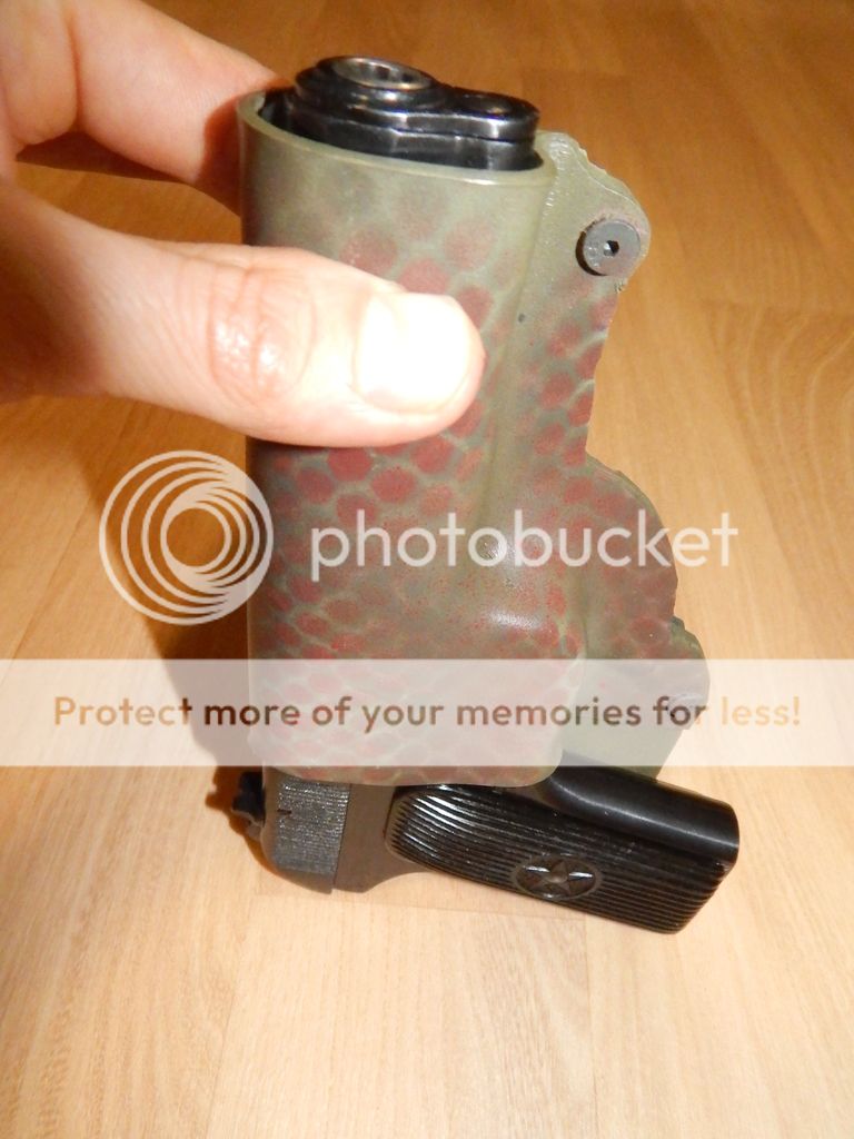

HOLSTERS AND SHOOTING
After just walking around gun clubs, firing ranges with my unloaded TT33 tucked into my jeans pocket and mags in the ass pockets, I started looking into getting a holster. There aren't many. Actually there are a few but they are almost all terrible. And they are also expensive and terrible.

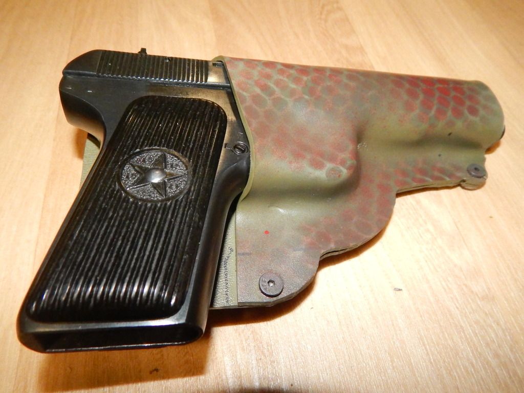

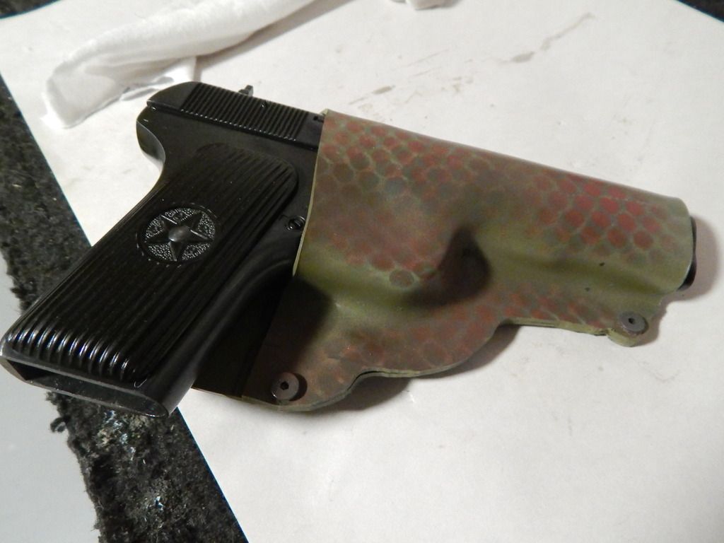

I ended up sick and tired of searching and wasting money and made one out of Kydex. Kydex is dirt cheap. I'll put some pics here in case anyone is looking for a starting point or ideas. I used medium thick 0.06". It works awesome. Looking at it now I would change a few things but it holds it solid enough to flip it upside down and I can draw it easily and quickly with one hand.
Hit it with some spray paint and clear coat.
So how do you carry the TT33 if you're actually going to use it on a range in a holster? Some say the TT33 does not have a safety, sure as Russia invented Communism, it does! It has a half #### safety. That being said if you chose to chamber a round and put the gun on half #### (I actually used to use this method although I physically inspected the sear and the hammer on mine disassembled). While half #### with a loaded chamber in a holster will make some prissy safety queens pass out and p**s themselves, I did not stop doing this because I had any fear of the gun or lack of confidence in the design etc It's actually just not very practical because you still have to draw it and #### the hammer with your support hand once you get it pointed away from you in a safe direction.
This is the best method I've found with a holster: Place a loaded magazine in the pistol, #### the hammer to full #### and place it in your holster.
If you need to draw (especially with your smoothed out gun now) you draw and when the pistol is half way up and in front of you with the muzzle now pointed at the ground/semi down range, rack the action and then take up the space on the grip with your support hand as you are starting to push the pistol out to engage your target board. It's surprisingly quick once you practice and put it into a fluid motion. I've heard tactical armchair experts on here call this the "Israeli Draw" I don't know if that's what it is. Meh whatever, it works really well!
