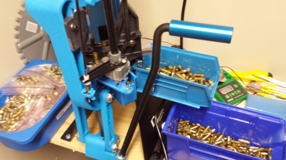

Ran out of Competition 9mm. So reloaded 800 rounds last night and now just need to gauge them.
Man alive, I tell ya, throwing them in the tumbler after loading makes them look like gold.
