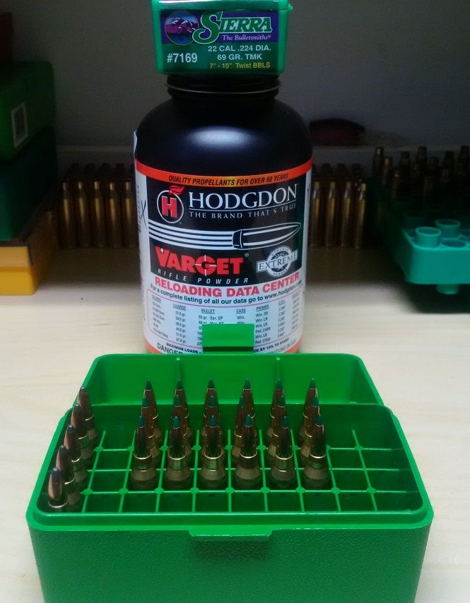

I reloaded the last 5 of my 65gr GK's to make room for the 69gr TMK's. I guess I had to blow off the dust on my reloading skillz too because I dropped the powder in then seated the bullet and saw a little pile of powder on my bench. Not thinking I thought some how I missed the case, so I pulled out the hammer thingy to remove the bullet from the case. As I was doing that I noticed that I didnt have a primer in the round that I just made. lol THey have been sitting there for a few months now and just forgot to do the primers. lol No biggie
Loaded up 24.9, 25.2, 25.5, 25.8 26.1 and 26.4grs of varget
The 65's shot good so Im thinking that the 69's should shoot better, I hope. :)
