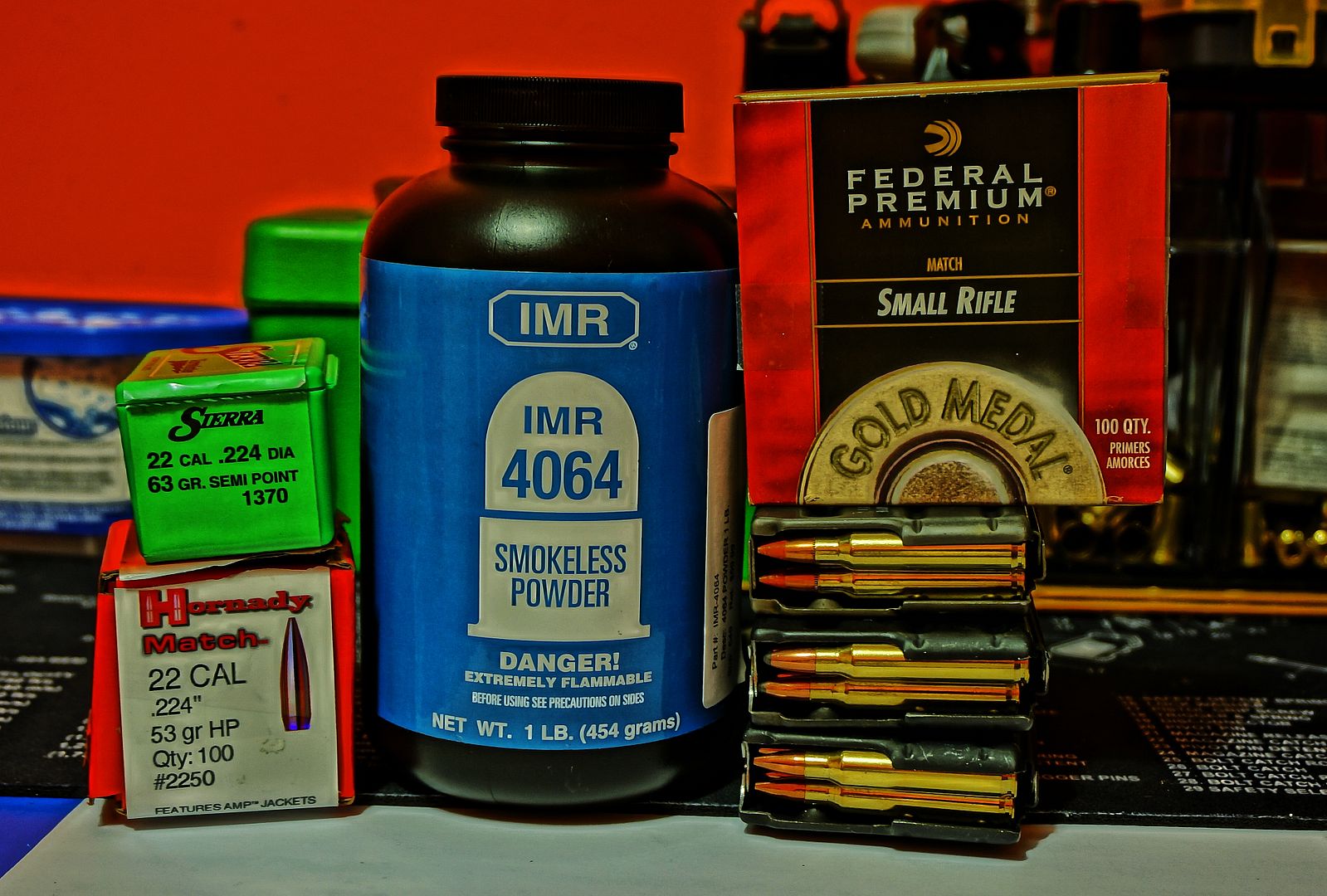

.223 IMR4064 test loads; going to have no shortage of various test samples (calibres and powders) ready now for a nice weather day at our outdoor range.
80 rounds of 41.7 gr 4064 with a 175 smk on top, in FGMM brass and GM210M primers. Copied the gold medal match recipe for 175 gr. Should be a good time tomorrow at Gen. Vokes Range.
