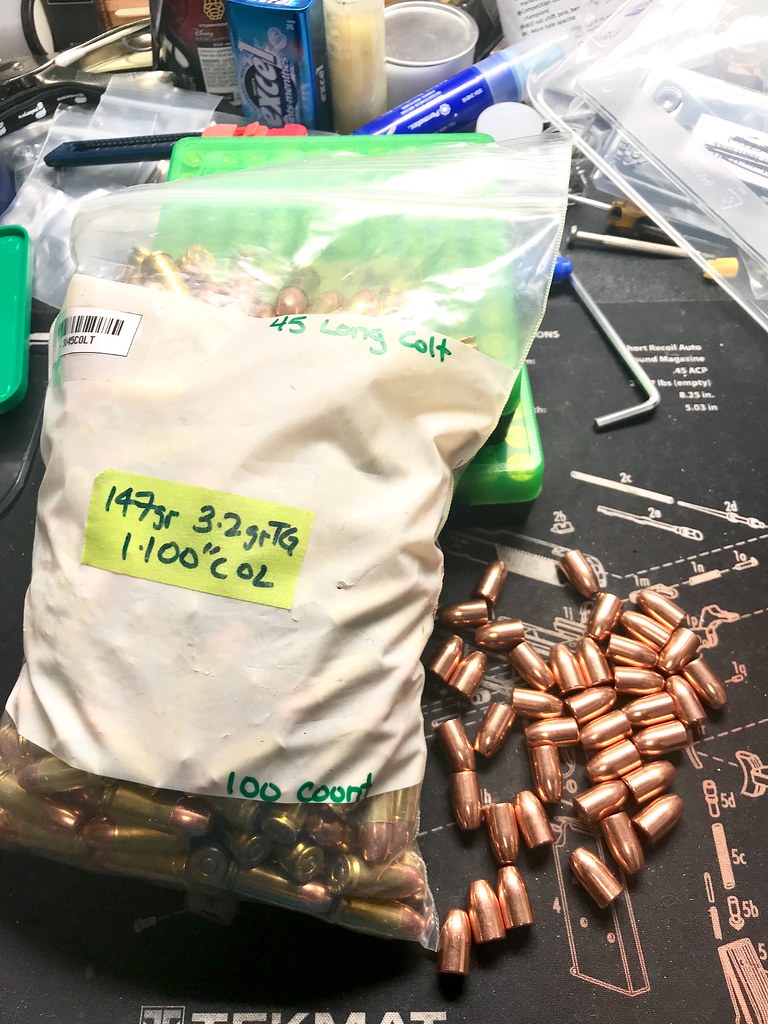

Spent the afternoon at the loading bench, loaded up 150 rounds of 300 Winchester Magnum. 210 gr Berger, over 73.6 grains of H1000, CCI250, PPU brass. COAL 3.5275".
Earlier in the week I loaded up 108 pieces of .45acp, 200 gr DRG, over 4.9 gr of IMR 700-x, Winchester Large Pistol Primers, Federal brass. OAL 1.216". Nice round in my M&P.
