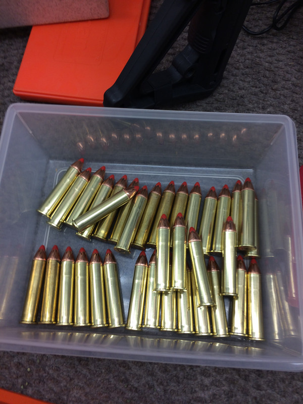

120 rds of 500 S&W
90 rds of 44 mag
200 rds 45acp
70 rounds of 455 Auto
Have a few calibers left to do before spring, but getting fairly well stocked up. Bring on some warm weather!!!

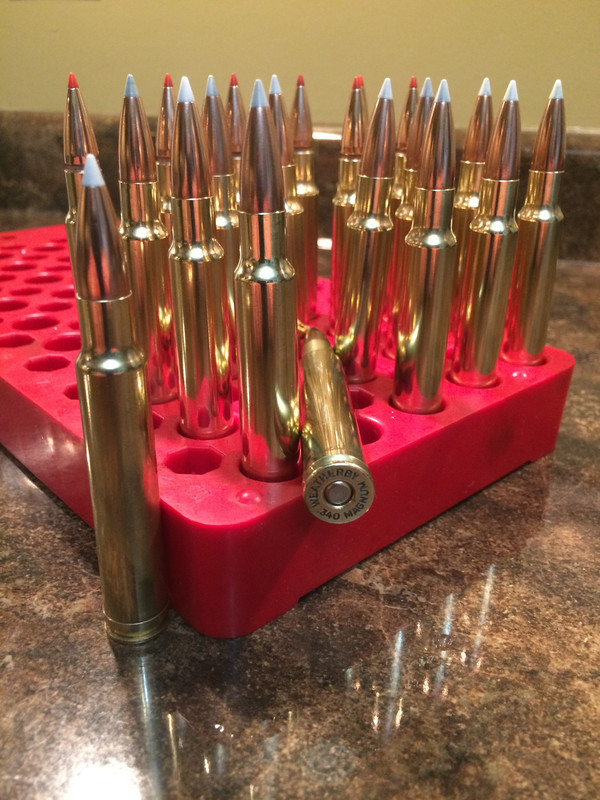

20 rounds of .340 Weatherby Mag. It's been awhile since I loaded some of these and I forgot the ridiculous amount of powder required. 85.5gr of IMR 7828 pushing a Nosler 225gr pill.(with a few Hornady's to finish it up since I ran out of Noslers)
Weatherby cases sure are pretty.

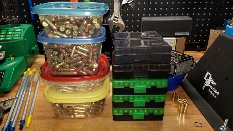

Think I might be good for 9mm for the season. Depending on how much I miss, lol. Now onto .38!
147 grain RNFP CamPro over 3.3 grains of Titegroup.
