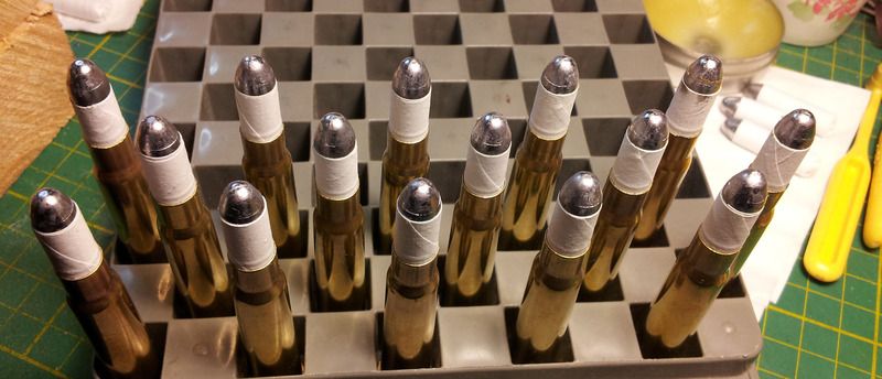

Paper patched .303B rounds. Started as .309" 200gr cast, PP'ed up to .317" or so. Trying them in a Martini-Enfield with a terribly worn bore; slugs around .316".
I know the wraps don't line up; this was more of a hail mary attempt to get the rifle to shoot before looking at having it rebarreled. I'll do the tweaking later if there's any promise. In the past I've found poorly wrapped bullets to still work but not shoot as well. If they don't keyhole, I'll be happy.
