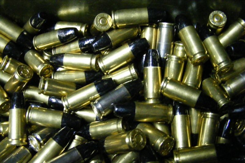

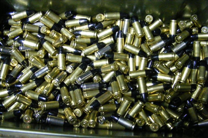

Just started reloading so my first 250 rounds of 9mm. Took them to the range and I get way more accuracy out of my handloads than any factory ammo I have put through my CZ 75. Very impressed and happy.
