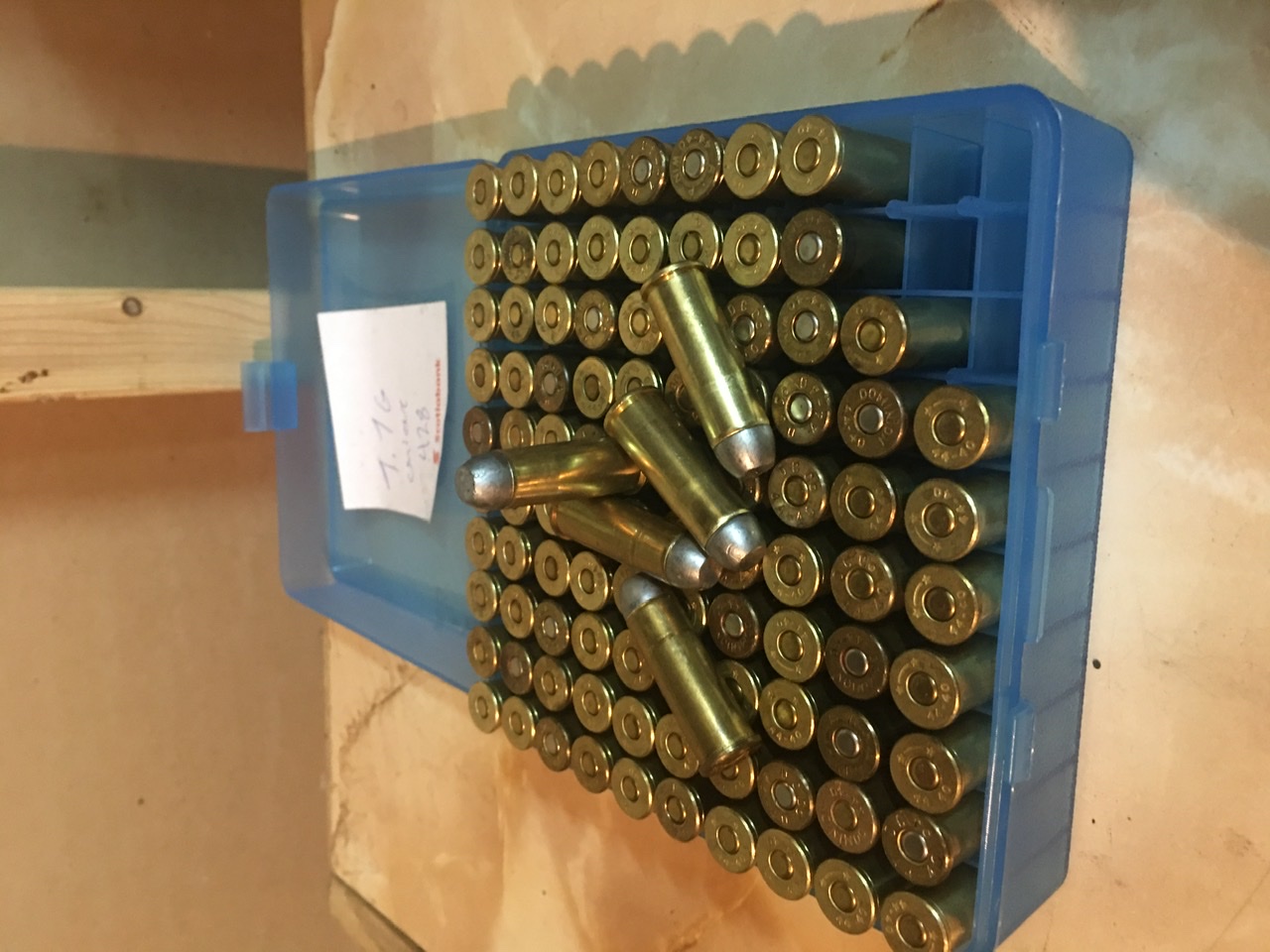

100 rounds of 44-40
Cast 200gr
7.7gr Unique
On a lee single stage
Whole process took me 4-5 hours from start to finish.
A labour of love
Only my 2nd batch of home rolled
I really enjoy the process so far

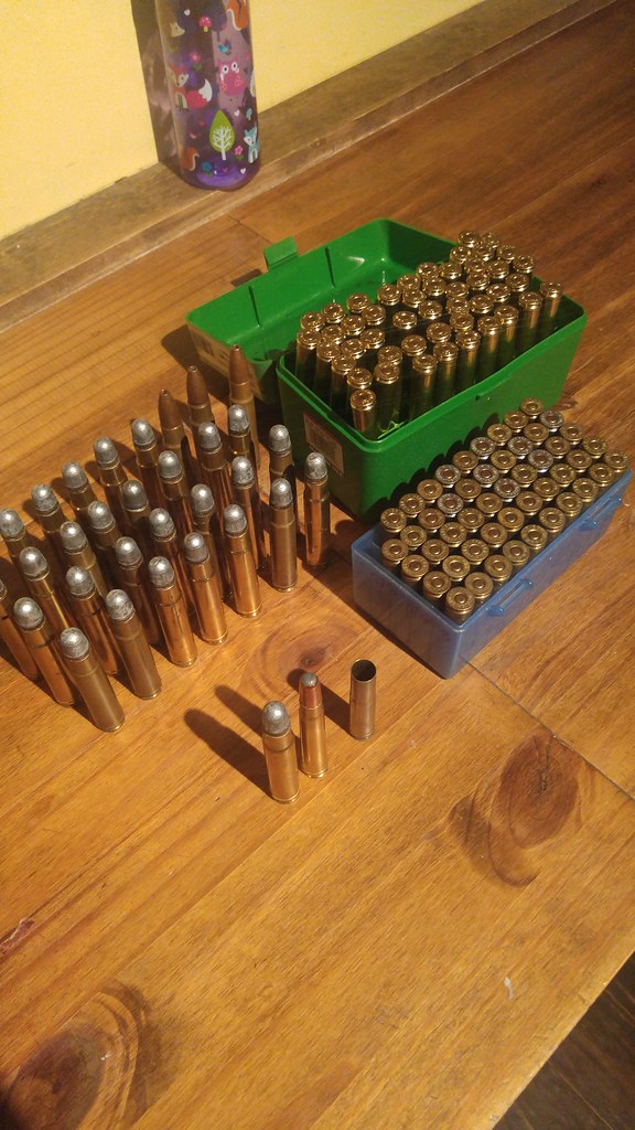

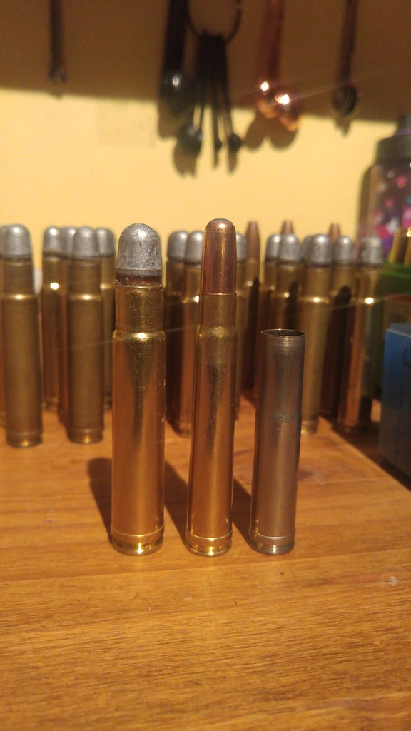

this afternoon i turned 20 416 weatherby brass into 460 brass and then loaded 30 rounds. 400gr cast bullet 80gr of H4895 driving it
loaded 50 375H&H rounds with 300gr jacketed. 70gr of W760 driving them
and prepped, resize and primed 50 43 Express cases
How's your 43 Express doing? Have you done any hunting with it yet?
Ted
Its doing well. Ive loaded these cases a few times now, i have 100 total. shoots well at 100m with iron sights. I havent used it hunting yet. But i do take it to the range. When i load these ill post the data but off my head i believe its 53gr imr3031, 360gr bullet and 1800fps. i going to work this next batch up to 1950fps i hope, giving me the 3000 pounds of energy i wanted.
