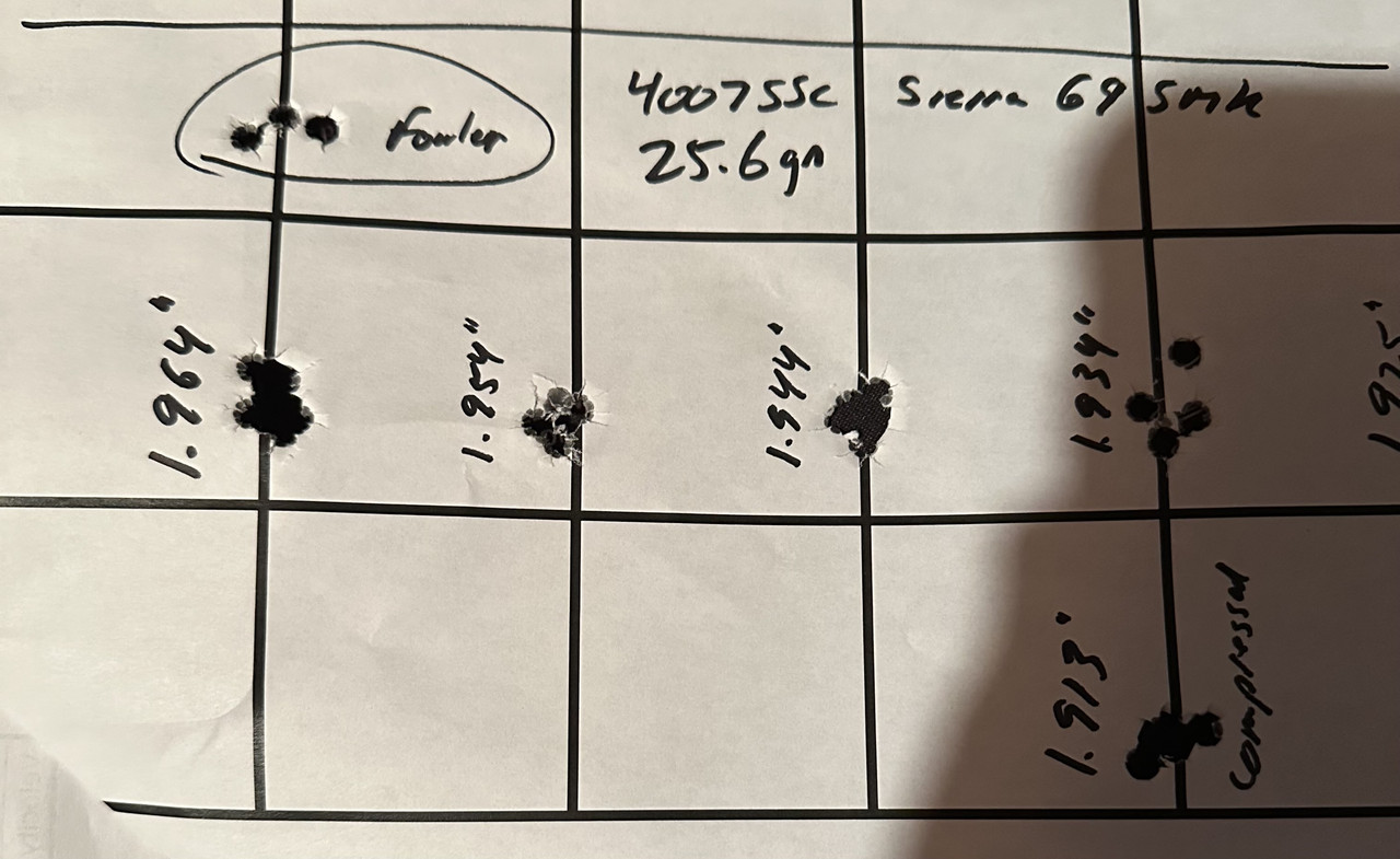

Loading .223
Found a nice load to finish off the last half bottle of a discontinued powder. I wish this was still around.
