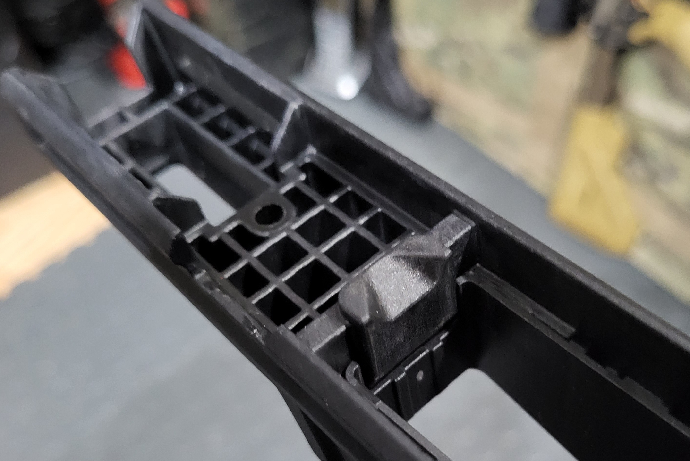

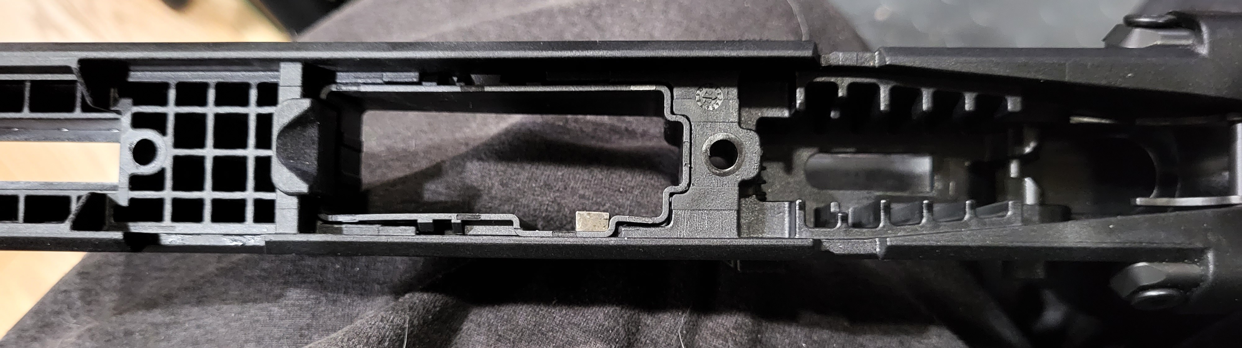

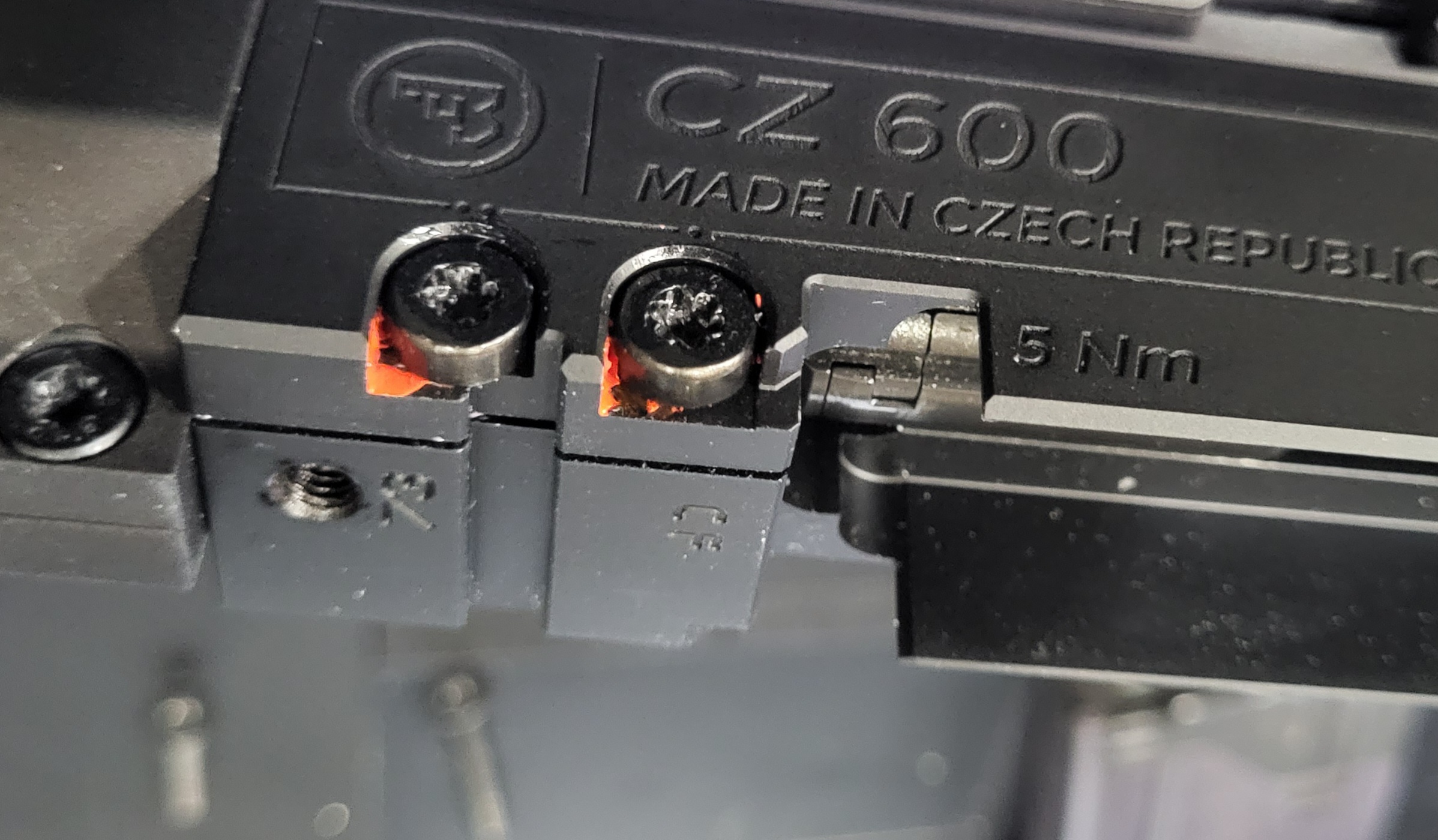

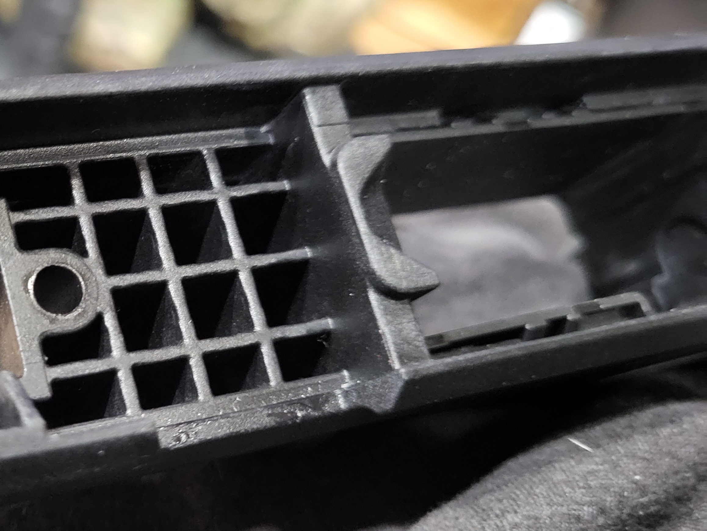

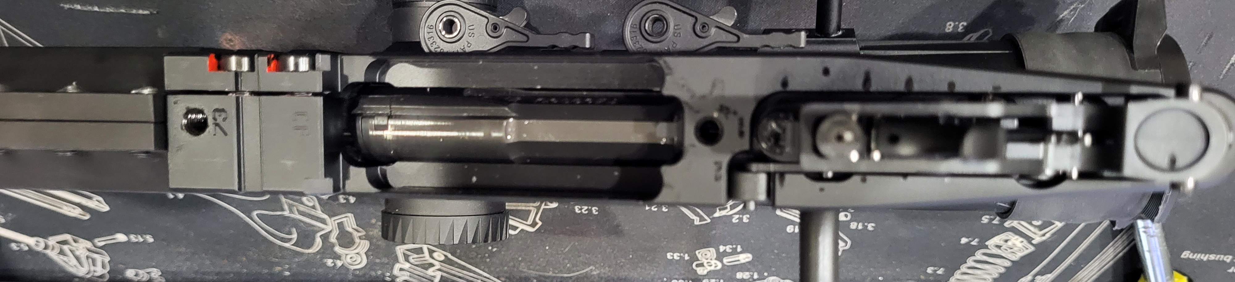

Here you go - the best photos that I can provide you with showing the "Bedding" system for the CZ 600 Trail. Bear in mind that this is a "Mini-Action", designed for .223/5.56mm and 7.62x39mm intermediate cartridges, so "Recoil" is moderate at worst and a polymer "Recoil Lug" may not be required to do much heavy lifting in terms of recoil mitigation. Still, it is indicatve of what you may receive in the iheavier calibre models of CZ 600 as well. The "Mini-Action" only has one row of Lugs on the Bolt (vice 2 rows on the heavier calibres), two Barrel Retention Bolts (vice three Bolts on the heavier calibres), and so on.
You can identify the Polymer Recoil Lug by the partial Feed Ramp that it contains, leading to the Steel Chamber of the Barrel.
The corresponding slot in the steel Receiver for the polymer Recoil Lug/Feed Ramp is identifiable as the deepest slot on the underside of the Receiver billet (the slot in the Trunnion closest to the "5 Nm" marking)
The wear properties of Polymer verrsus Steel over time are a mystery to me, so I cannot say if one is superior to the other under recoil, over the fullness of time. Let's just say for the sake of argument that they are equal. I see no benefit to having the slot in the Stock and the Recoil Lug as part of the Receiver, versus the opposite arrangement as found on the CZ 600 Trail with the Stock's polymer Lug fitting into a corresonding slot in the aluminum underside of the billet Receiver. Both approaches ought to be equally effective.
I do no doubt that CZ Europe did conduct extensive reliability, durabiility and accuracy testing of the CZ 600 line before bringing the new product to market. To not do so would be quite a departure from the norm! The "Recall" was all about the possibility that a non-mechanically-inclined person could reassemble the Quick-Change Barrel incorrectly, resulting in a Firing Out Of Battery condition with the Barrel not fully seated and the Bolt therefore not fully locked into the Barrel Extension. Anyone with an iota of common sense and firearms familiarity would know that the Barrel is not fully seated in the Receiver and would/could correct the situation long before it became a problem. However, based on "that guy", SIG (maybe just SIG USA?) elected to do a recall and make the Barrel Retention Bolts permanently instralled, thus negating the remote potential for a switch-Barrel installation error. It is interesting to note that aside from IRG's CZ USA offering, all CZ Rifles distributed in Canada are manufactured by CZ Europe. My CZ 600 Trail is European, and aside from a dab of red enamel on the head of each Barrel Retention Bolt, there is nothing whatsoever "permanent" about the Barrel installation. Indeed, it is still very much "ready and able" to be disassembled and Barrel-swapped for a different calibre such as .300 Blackout, or (with a Bolt-Head swap), 7.62x39mm fed fromm "STANAG"-style 7.62x39mm magazines. 6.5 Grendel, 6.8 SPC, 6mm ARC, the possibiities and capabilities are many and varied!
